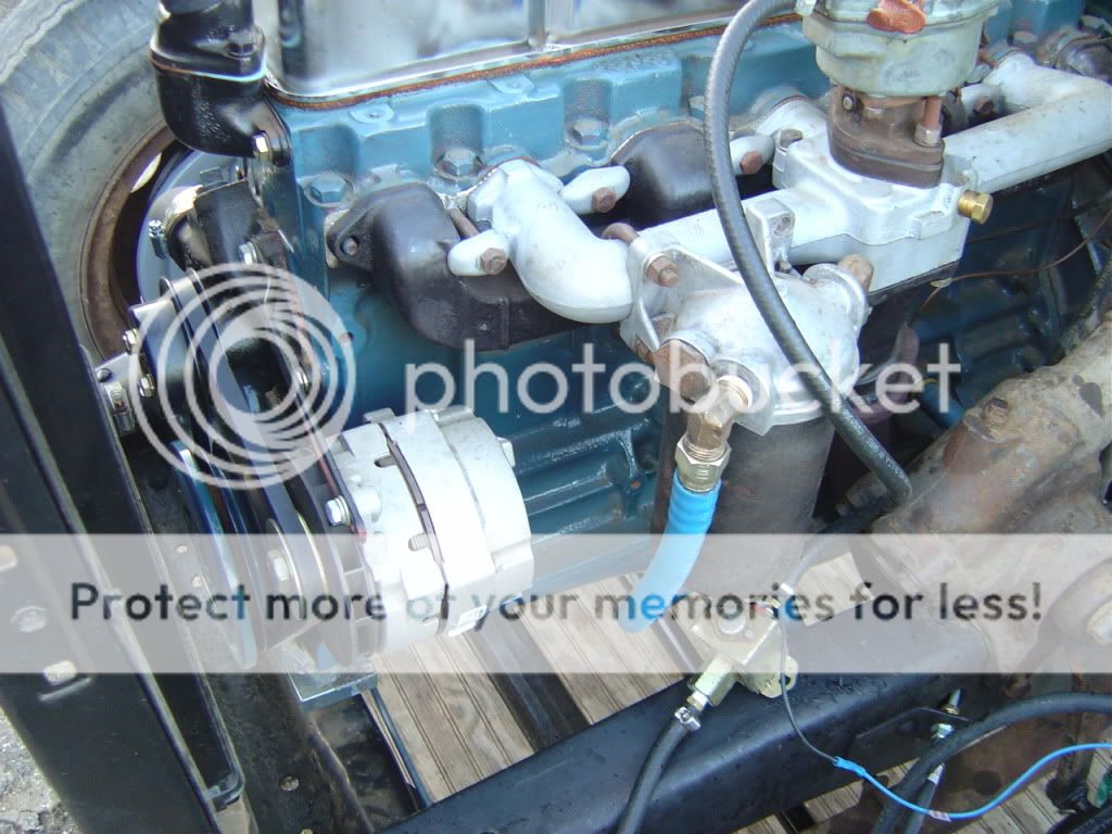

heres my water pump set up.it was actually a long shaft that we shortened to a short shaft to clear the radiator.

Just so you know what you are (and are not) working on: based on the location of the water pump, the engine in your photos is not a 54/55 261. The earlier 261s (you said you are a 1953) would not need a water-pump adapter plate, because the water pump would be higher on earlier 261s. The 261 came into production in 1954 (but some might have been cast in 1953?).

Something I noticed in the pic of the pump, the pulley looks awfull small compared to other late 235/261 engines I've seen. Are you running the 216 pulley? That will overdrive the pump, causing cavitation/exsesively fast coolant flow.
