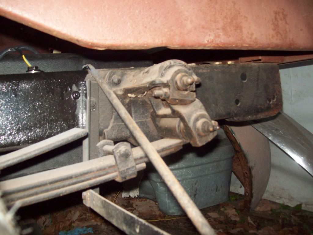

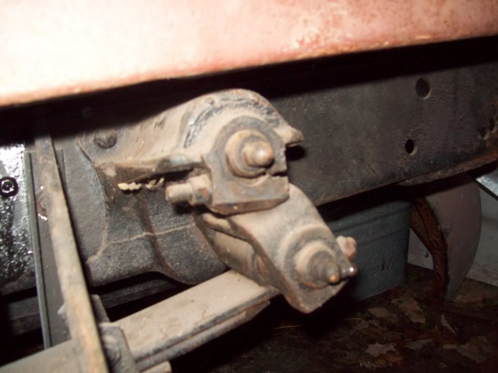

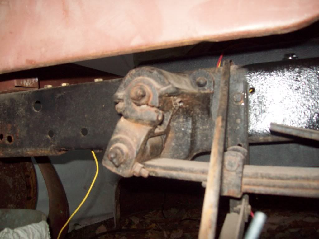

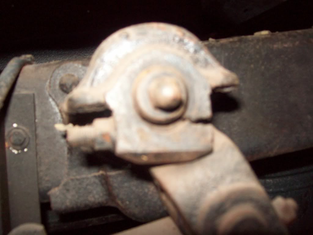

as you can see in the picture the ones I have are broken. Im not sure if they are repairable (should I try closing the gap and welding it back together?) or if I should just replace them.

I'm not sure that shackle exention should be there. It almost looks like that's what broke the bracket,

They look original off a 3/4 ton frame. I sent you a message about the ones I have. Here is the assembly line manual page for the 3/4 ton... Manual

They are original to your truck. I see these on ebay quite often.

It looks like the lock /wedge bolt was way over tight, never under estimate the power of the inclined plane.
