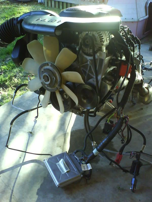

I found my drive train it is a 5.3 out of a 2006 tahoe. the truck was totaled when it had on 53 miles on it. so everything is new.
Motor1
Motor2
Motor4
Last edited by KCMongo; 08/08/2008 4:16 PM. Reason: Missed this one, changing Images to links. http://www.stovebolt.com/news/2007/december2007/index.html#forum

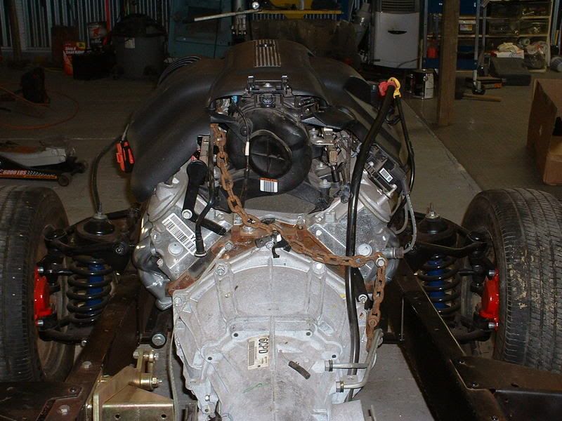

Mark,
Looks good.
Looks like you using SBC motor mounts and then adding in or building some LS1 adaptor plates?
What gear ratio are you running in your 9-inch and did you buy it built or did you buy the right width and weld on your own spring and shackle mounts?
Also, looks like you went to hydroboost due to fitment problems of a vacuum booster and the 4l60E?
I am planning a similar swap in my '59. I have a local yard looking for a low mileage 6.0L. I'd be happy with a 5.3, but the 6.0 would be a bit faster and the price on them seems to be going down around here with the price of gas going up. I have the MII front end (Fatman's Fab) and power master cylinder in stock location. I am concerned that master cyl, transmission, and driver side exhaust will all want to go in the same place.
I have been thinking about a 3.25 or so gear ratio with the 6.0 motor, rather than something like 3.71.

yes sbc mounts with adapters. the adapters are available from several sources, theese were given to me. my rear ratio is 3.70 it is out of a 70 ford pickup and is right at 60 inches wide so no narrowing was needed. I used a TCI rear leaf and shock kit and welded brackets to the 9 inch. this will lower the rear 4 inches. and yes hyroboost was necessary for clearance, the performance will be a plus also. the 6.0 will get considerably less gas mileage. the 5.3 has 295hp stock and I have a tune from wait4me performance good for another 35hp. 330hp should be enough. exhaust on the drivers side will be tricky to keep the heat off of the brake system but I have a plan. check back later

I have a turbo on my track car and it is on driver's side of engine compartment near firewall mounted master cylinder. Plenty of heat around the brake system. I wrap everything in that aluminized heat wrap stuff, like this: http://store.summitracing.com/partdetail.asp?autofilter=1&part=THE%2D11600&N=700+400356+115&autoview=sku
I also cut a simple sheet of aluminized roofing flashing and safety wired it between the turbo and master cylinder. Easy to do.
Works fine. You will notice boiled brake fluid going from 135 MPH to 35MPH every 30 seconds (rinse and repeat) on a road course, and I have not. Stovebolt is not going to slow down that much.
Lower cost alternative is HVAC foil tape (ala Home Depot), but sometimes the sticky melts off the back of it. I stick it to the bottom of my fiberglass hood, otherwise the hood starts to grill and it is probably 8 inches away from turbo and there is a heat shield in between.
