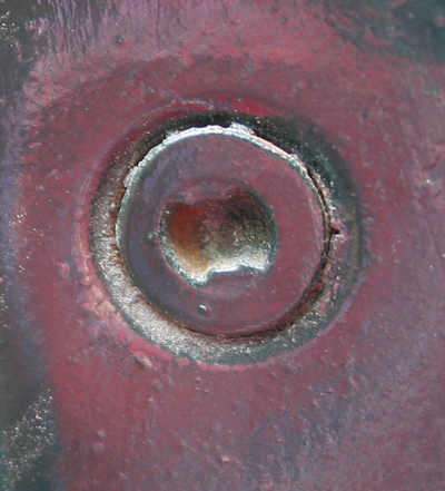

I just bought a 1952 dump truck this week and everything I want to work on so far is attached with bolts with heads I've never seen before.
Can someone please tell me what you call these? Thanks!

Be prepared for them not to know what you're talking about, though. The clutch head hasn't been used for quite some time, exept for some odd trailer applications. If you can't find them at the flaps or hardware store (Sears doesn't carry them in the stores BTW) Snap-On, Mac, Matco, and S&K still have them. You might check with a local repair shop and find out when the tool guy comes around, and if it's OK with them if you talk to him at their shop. Some places are touchy about that. I've been booted off of a few car lots trying to catch the tool guy 'cause i couldn't catch him at work.

Those are the clutch head screws. Check out evil-bay,,i recently saw a set of screwdrivers on there.

That photo is a door latch bolt's. Smaller ones are used on the brake light switch. Thankfully a little WD40 took care of a sticky brake switch, and there was no need to remove it.

The clutch head drivers are readily avaible at many places. NAPA usually carries them,but they are a little pricey.Most of the mail order outfits,Chevy Duty,Brothers,etc.sell a complete set for under $20.

You can use a flat blade screw driver in a pinch. You have to make sure you're flat & straight with the screwdriver if you do because it's easy to round out the hole using a flat blade.

as Tiny stated A flat tip will work I have had good luck with a flat tip screwdriver , but search through your collection to find one that fits in as tight as possible to avoid strippin out the head.

You can get a nice set of 4 clutch head screwdrivers from Classic Industries, page 456 of their truck catalog for $19.95. I also got clutch head bit drivers from Matco Tools that work great with a ratchet. I know a couple of Matco guys in the Chicago area. Let me know if you need the contact info.
