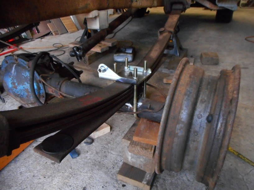

I had a 1953 Chevy 3800 several years ago now...I took the whole rear springs and hangers and rear end out and swapped out brand new leaf springs from the fine folks at STS spring company they were originally found on like a 1998 Chevy 1500... new rear spring view
I am not sure if this helped the ride or not but it still rode like a old truck to me...nothing like the way the new stuff rides for sure...

Nice score. About what I spent on the rubber material and you didn't have to mess with it. thumbs_up
Kevin
1951 Chevy 3100 work truck

Did the rubber material hold up well?
52 Chevy 3100
Jesus said to him, "I am the way, the truth, and the life. No one comes to the Father except through Me." -John 14:6
PastorMatt #1590054 10/20/2025 6:11 PM
Joined: May 2015
Posts: 10,997
Joined: May 2015
Posts: 10,997
I used it on the axle pivots and they are doing fine. The issue I had with the first try on the transmission mount was that the material had expired and wouldn't set up. The supplier said it's only good for 6 months unless stored with a nitrogen padding. And I don't have any nitrogen. The axle pivot bushings were done with fresh material, as is the re-do of the transmission mount.
