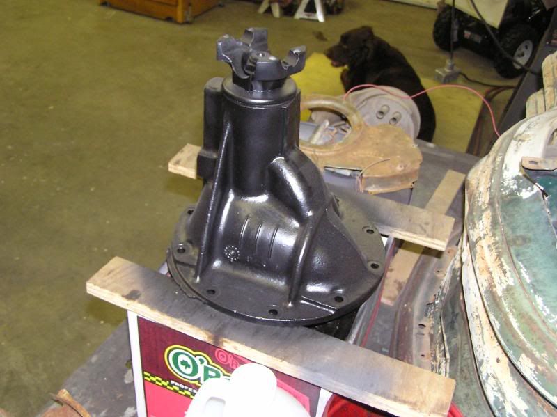

I put a 58 pumpkin in my 1951 suburban rear end with a 3:90 gear set,coupled to a t5 transmission.
Here is a link to some pictures I took of my conversion. conversion pictures
I extended the splines,shortened the collar and pilot shaft area.I also used a 1/2" drill bit to open up the transmission mounting bolt holes. t5 conversion
