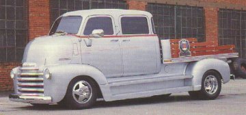

I am tossing around in my head an idea of making a crew cab out of my 49 6400. Does anyone with welding skills think this can be done relatively easily? I want to have 4 doors on it, not just stretch the cab. Any suggestions on this, or am I living in a pipe dream? Thanks, Mike

been done before - not 'relatively easy' tho, and of course will need a 2nd complete cab - but pipe dreams are what life\'s made of ! grin
one of the problems is getting the roof crown worked out

Here\'s one from the KC truck show that was really well done. It's a 4WD dually though but I liked it. There's a bunch of other fellas that have seen it too,

It take a fair amount of metalworking knowledge to do this right. It also requires access to metalworking tools that are not commonly available.
There are a few companies out there that specialize in this type of work. They usually work on new trucks, but can be persuaded to work on older vehicles. These companies try to avoid older vehicles because there is usually a lot of rust repair and structural beefing that is necessary to do it correctly.
Crew cabs are not cheap. Expect to pay at least $10,000 for all of the sheetmetal work and frame lengthening. The custom crew cabs on new trucks can run $30,000 to $40,000 out the door.
One company that comes to mind is Alton Fabrication. I think they are in Minnesota, but I could be wrong about that. Another is Byers Autobody, in that same general area of the country.

I know the guy that built the red one that was a the truck show if you seart for me in some past threads you should find one where I posted some of his buildup pictures. His rear doors are made from 2 doors a piece to get that same angle front and back.

On the crew cab issue, the roof is a real bugger to get right, from what I've seen.
