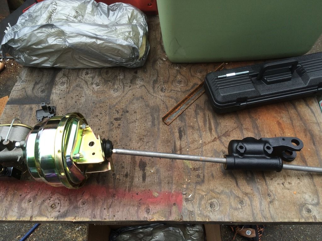

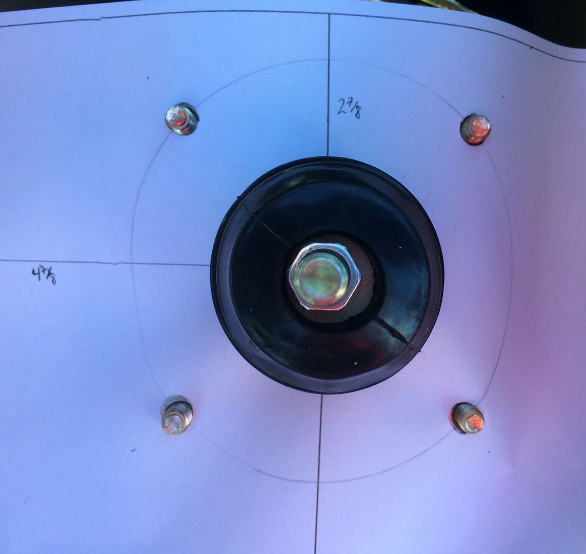

OK, I got my set up today. Original MC is cleaned out and painted. Here is a pic of them. Essentially the new booster and MC will be mounted 2-3' back from the original MC. Original MC will be bolted in the original location and used strictly for keeping the brake pedal in the same place with the pivot point. I have some steel stock material that I will machine on my lathe to make it the right length and thread it to mate up with the new booster. Then I can run the new brake lines to the front and rear from the distribution block under the new MC that also holds the brake light pressure switch and proportioning valve. New Booster is an 8" dual diaphragm and the new MC is 2 chamber with a 1 1/8 bore. I think it's looking good so far for the swap. Sorry about the night time pic.
http://s107.photobucket.com/user/fc...AB-0DF407FFDB28_zpstglopish.jpg.html?o=0

Sounds promising. I understand how you plan on using the old MC body to hold the pedal at its original pivot point. That sounds like a good idea. I'm not sure how you're connecting your new linkage rod to the pedal, but maybe it would be obvious of I crawled under my truck and looked at things.

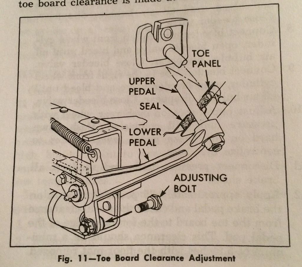

Here is a diagram from the shop manual of the pedal attachment. Shouldn't be hard at all to put them together. Thread the end of the pushrod and attach with a heim joint.
http://i107.photobucket.com/albums/...5-450B-A50A-2764ABF797CA_zpsjr6ssxgi.jpg

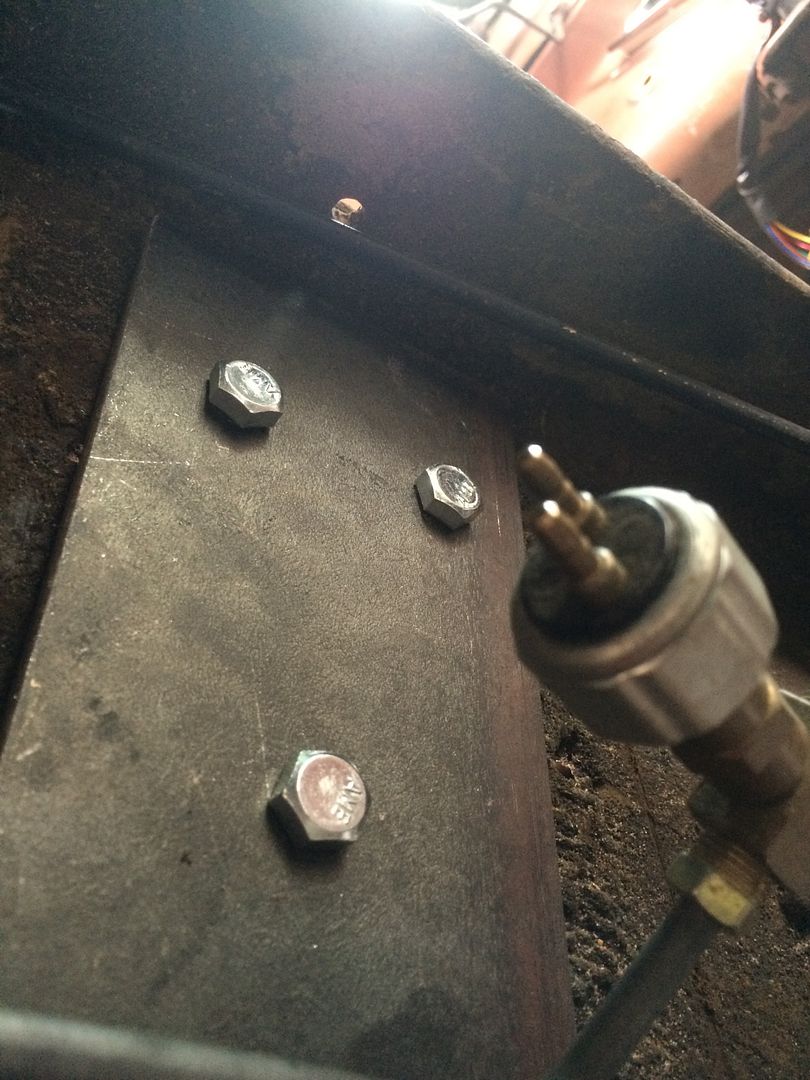

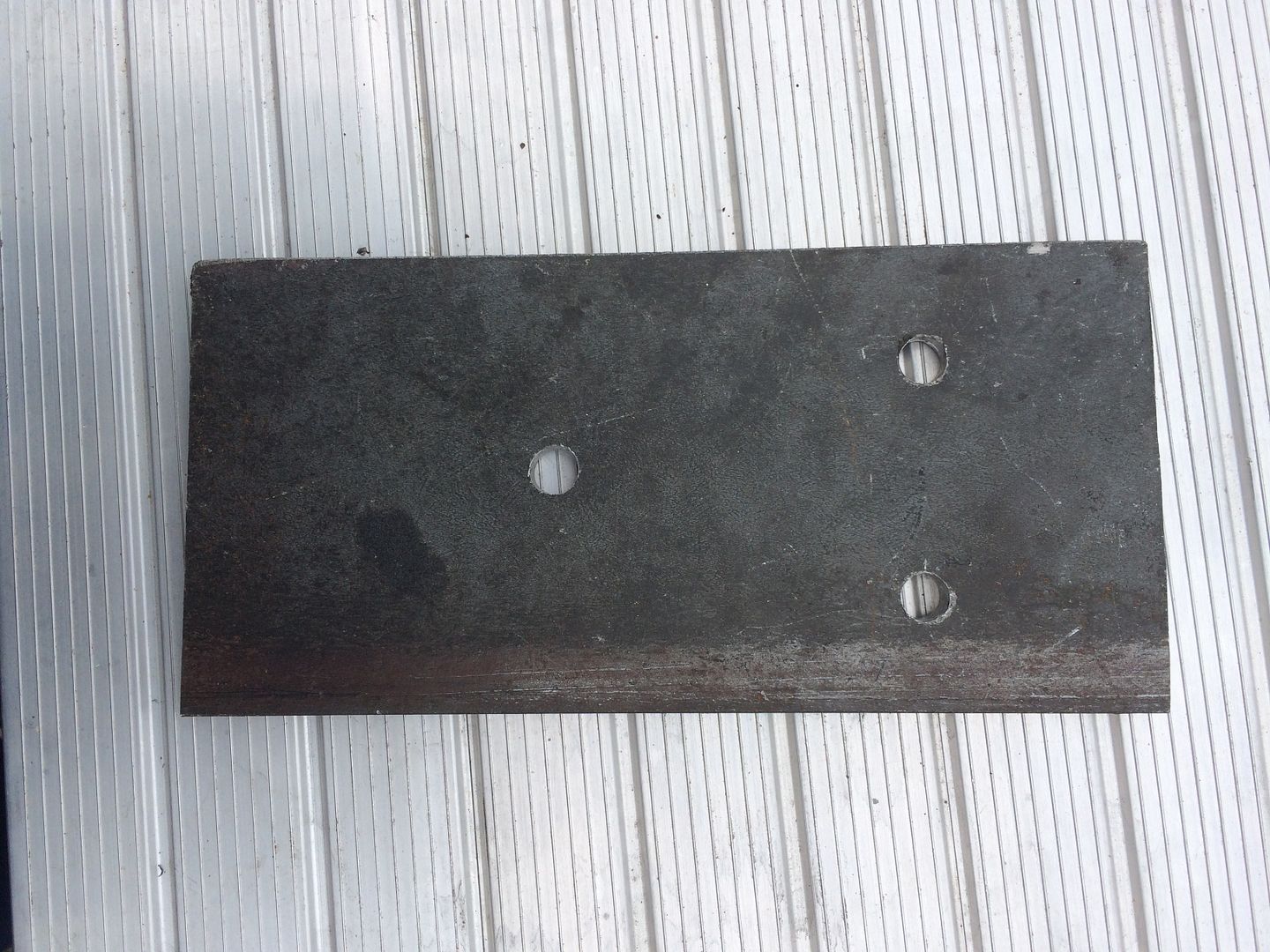

A little more progress. I have the plate cut and the side mount to the frame drilled.
http://i107.photobucket.com/albums/...0-41E4-8AD7-25C1154A146F_zps57xcrysp.jpg
http://i107.photobucket.com/albums/...D-422C-B5E3-F17756EA0AFD_zpsqnqdjcxt.jpg
next is to get the booster mounting plate measured, drilled and welded to the frame mounting plate.

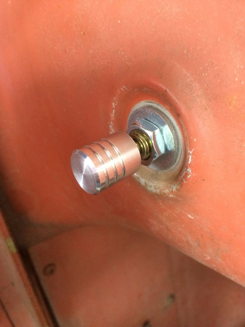

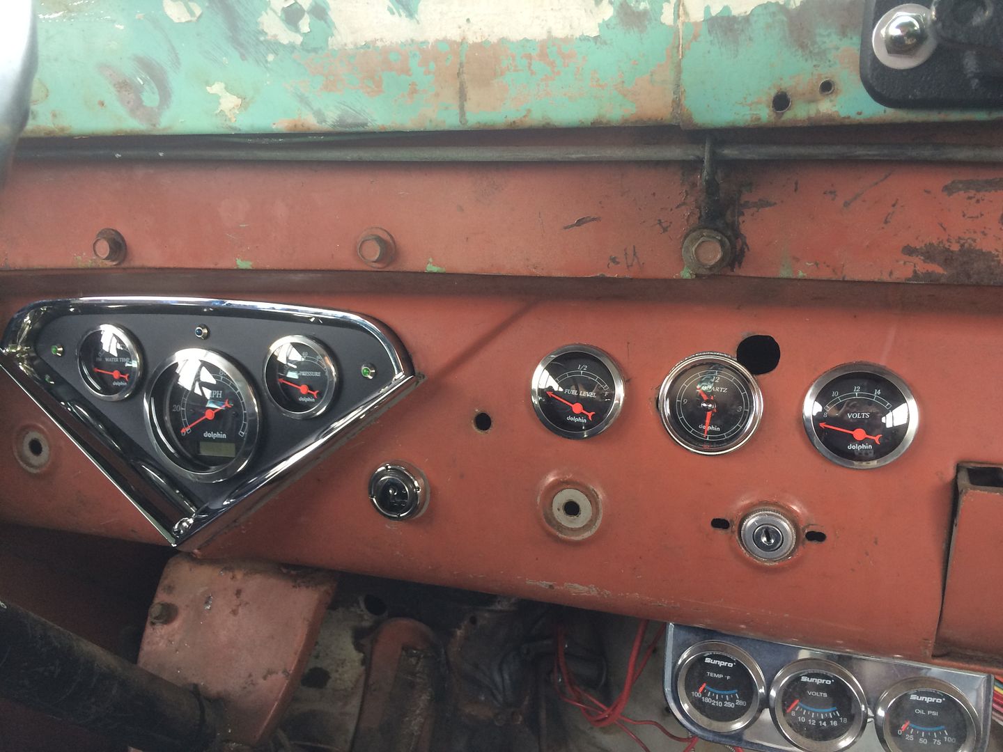

I also got the gauges set up too and ready for wires. And made a custom piston knob for the headlight switch. A little off topic, but I think they turned out nice. Dash needs some cleanup and paint though. Later this week.
http://i107.photobucket.com/albums/...1-4101-BCF0-04C095D8ADA3_zpsm5jf61a7.jpg
http://i107.photobucket.com/albums/...C-484C-9CD8-CA6F9A6B40B4_zps4nxb1sxq.jpg

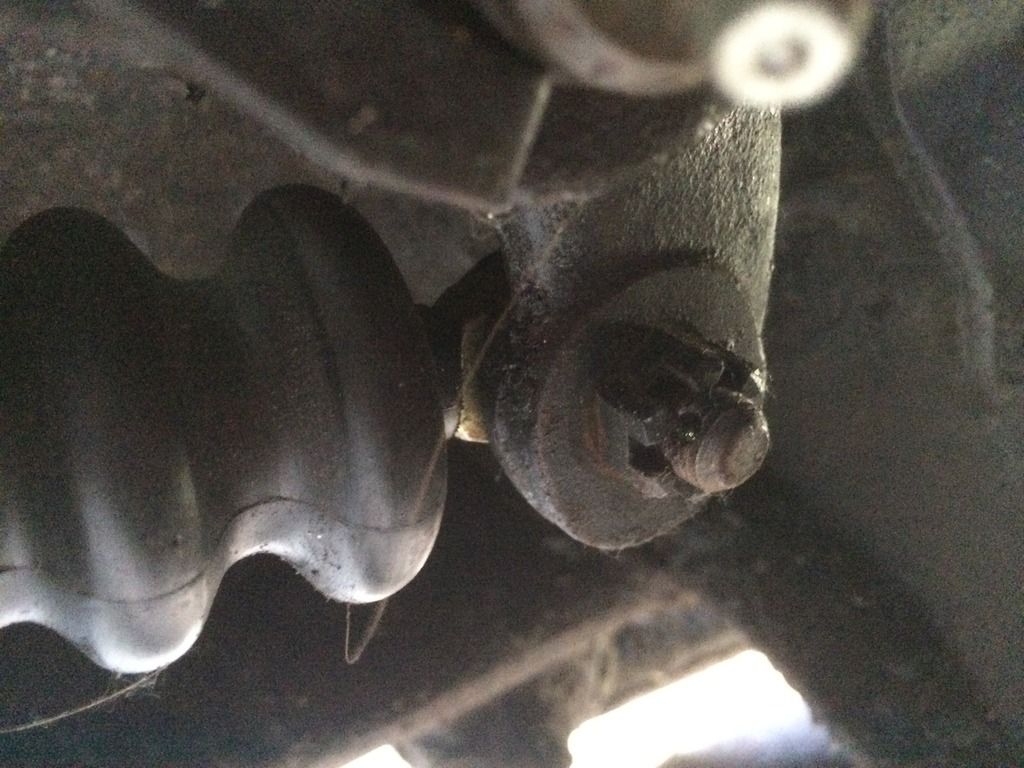

Well I got a little more done today on the brake system. My motor lost a lobe on the camshaft and long story short it's at the machine shop due to the metal from the cam grinding everything up, literally. So I thought I'd get moving on the brakes while I wait. I got the MC housing mounted, brake pedal set up with the heim joint hooked up to check for clearance. That is basically as far as I've gotten today after cleaning up and repainting the engine compartment. I'll do the bracket work this week for installing the new Booster and MC. Looking good so far. Here's a few pics.
Engine Compartment work:
http://s107.photobucket.com/user/fc...47-EA4A6BB98C7C_zpsytbxi8qp.jpg.html?o=7
MC and Heim Joint:
http://s107.photobucket.com/user/fc...07-7B4AA8A8AE04_zps5ns1v8s8.jpg.html?o=6
Heim Joint alignment:
http://s107.photobucket.com/user/fc...5A-CC9F5DE92775_zpsm02nnn5a.jpg.html?o=5
http://s107.photobucket.com/user/fc...40-6DFB45E1C227_zpse3t7xsks.jpg.html?o=0
http://s107.photobucket.com/user/fc...0B-97EE6E278BA1_zps2eioc0jv.jpg.html?o=2
http://s107.photobucket.com/user/fc...4E-800EAD7F9838_zpsrtudfyer.jpg.html?o=3
More to come in the next week or so.
