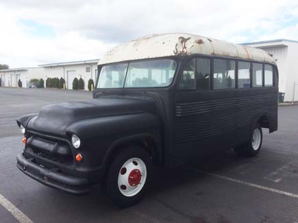

So the short bus hunt was on and I found it only a couple hours from my house.  I towed it home. It sat for a while but worked on it every chance I could get and when funds would allow.
So far I have rebuilt and installed a fresh Chevy 454. The old rear axle gears were 6.17s and wound that motor out. So I found and put in an axle with 4.63 gears and disc brakes from a 2001 Chevy HD3500.  It had the same bolt pattern for the wheels, too.  Now that engine and bus speed are better.
I have it at my friend’s shop he opened a few years ago to get some much needed assistance.  I cleaned up the outside and inside paint scraping the rust and treating areas.  It’s sprayed in black primer right now and will stay that way until I move on to the real bodywork.
I just started installing the new wiring harness this past weekend.
I acquired a TH400 transmission to go in it in a couple of weeks and the new exhaust will be 3” single running through a single semi-truck turbine muffler.  Should sound pretty good too!
I have had the involvement of all of my kids throughout the entire project -- cleaning parts, tearing out old stuff, installing new, fetching wrenches, and just otherwise having a great time working together on it.  The details going into it are as follows:
  • Flat Black body paint with red trim pieces that match the engine and transmission
  • White cap roof
  • Red Engine and transmission with flat black engine details
  • White wheels with red brake hardware you can see through the five hand holes as the wheels are turning
  • Black vinyl interior with red piping trim
  • Gray ceiling paint with a charcoal carpet
  • Sound system will be 4-6 6x9 speakers and an amp to power them from a simple cd player/tuner up by the driver
  • And finally, I’ll be pulling out some leaves from the very tall and ridged stock suspension to soften the ride and lower it about 4” and give it a 2” hot rod rake.
All of this just so we can go hotrod cruising as a family and to car shows.  The kids are 18 (just graduated from HS), then 16, 13,  10 (twins) and my youngest is 7.  All are very much involved in the work.
The bus is physically located about 45 minutes away from home -- between home and work. So I just stop and work on it for a couple hours several nights a week. My wife is very supportive of me doing that right now so we can enjoy it this year.
