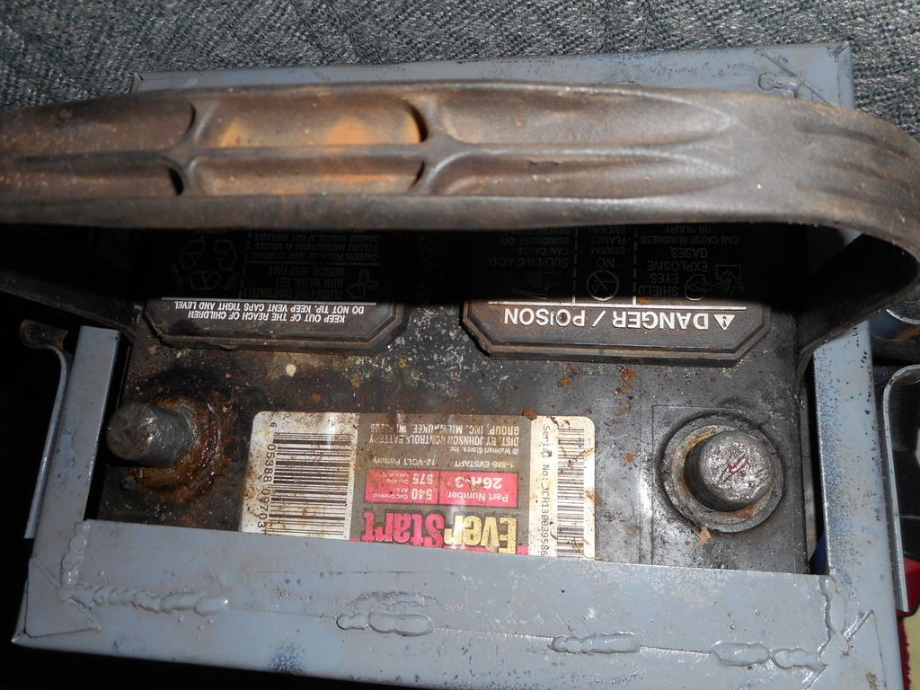

pretty sad when the battery costs more than the starter does...oh well...
It turn over and I popped once or twice...just doesnt seem to have enough to make it turn over fast enough...
We will see...
MikeC
P.S. I got the NAPA battery before work this morning...cost a little less than $90.00...I turned in the old starter so that was another $17.50 off the final price....so yes it did run more than the starter was...hmmm

Hey Mike, Just a thought....
Where is your ground wire from the battery attached?
I have usually found that attaching the ground wire to a starter bolt seems to work the best.
Hope you get it figured out, The truck is looking good!
