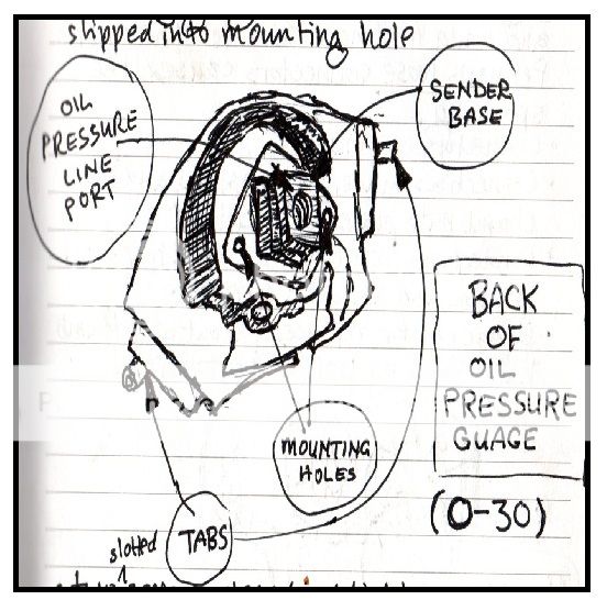

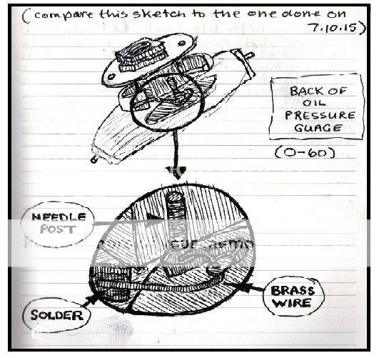

Replaced the original 0-30 oil gage with a 0-60 Belinda got me last Christmas.
Got the gage cluster back in and noticed the needle had dropped out of sight! Took the whole thing back apart and saw where the connection from the needle post to the sensor had come apart at the solder.
Soldered it up and it works fine:
pic 1
After looking at the original gage, noted that they don't make 'em like they use to:
pic 2
