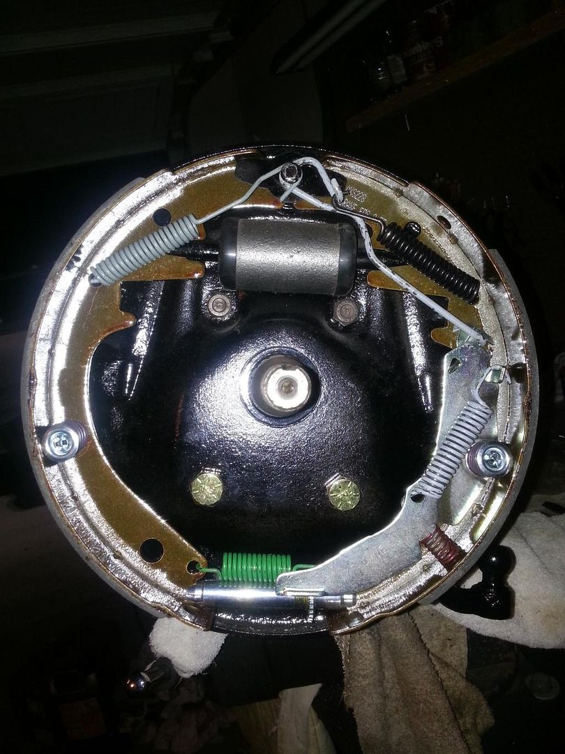

I got my driver side front drum brake back together with auto-adjusters added.
Now putting the hubs back together.
Does anyone know what a good grease is to use with my original style ball bearing wheel bearings?? (I've researched an come up with the old style "fibre" grease but I'm not sure what the modern day equivalent is)

locogringo , The picture showing the Driver side brake drum. Should`nt the short brake lining go forward and the longer lining go on the back? I seen this happen the brake shoes put on reverse and they Lock up. Just asking. Steve D

Good catch Steve D, he'll need to correct that, so he doesn't have any problems.

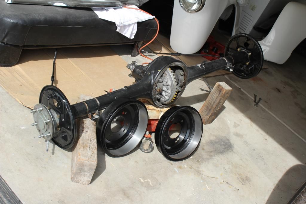

On the Good Humor truck, I just received back from Adams Driveshaft a total over haul on the 1955 axle. Turned the rear drums and press on new wheel studs. Installed new rear brakes. With new parking brake cables and doing a complete overall on the parking brake system.It works great.Also installed the rebuilt driveshaft over the weekend.I need now the two batteries and the Waldron exhaust system and ready to fire up this engine.
Rebuilt rear end.
