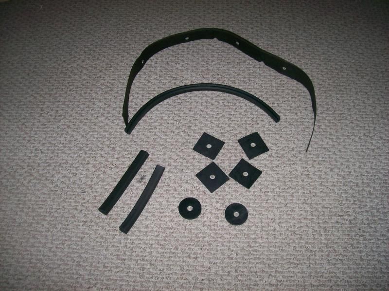

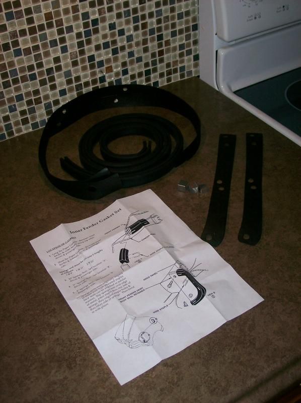

I was hoping someone could set me straight on an issue I have, I have bought two kits, one called a anti squeak kit and the other is called a inner fender gasket kit.
I have read in that monster post on assembling front fenders and I have found posts about the material used to make the gaskets but I could not fine detailed info on where exactly these two kits go, you will have to bare with me as it wasn't me who took this truck apart and this is my first truck. Thanks in advance.
Ken
Kit 1
Kit 2
** In kit 1 there are 2 each of the bigger pieces at the back, they were not included in the pic.
Thanks for the help with the post.

One kit looks like a complete kit, while the other is the fender seals only. I don't know what kind of truck, but the additional parts look like radiator support mounts, or something like that.
Posts: 53
Posts: 53
Sorry about that, it is a 54 Chev 3600 long box.
The first kit is from LMC here on this page part number 15 and the other kit is from Classic Parts here and as you can see they are both different in which has caused me some confusion. Kit 1 looks like a more complete kit although there was no staples and kit 2 looks like just the seals as you say but with staples.
I understand the long tar paper in kit 1 goes between the fender and skirt and the long foam piece in kit one fits on the top front edge of the skirt, I am just not sure where the 4 square rubbers go or where the 2 round rubbers go and the small foam pieces as well.
I think both kits are for the same thing just that each have a few different pieces. I have read about having staple holes in the skirt for kit 2 but there where none in either of the skirts I have. Thanks for the replies and any help at all is really appreciated.
Ken
Joined: Feb 2014
Posts: 215
Joined: Feb 2014
Posts: 215
Somebody familiar with the model years will have to help you. Some kits do come with parts that fit some model years and not others, so you may not need all the pieces.
Your LMC link shows: part number 30.2319 for 1947-55st
I have no idea what the small square and round parts are?
The Classic Parts' 37-725 is for the same years
It looks like the Classic Parts kits come with the foam rubber channel to seal the Firewall Filler Panels

I think those pieces were more 'gaskets' to keep road spray from between pieces and out of the engine compartment, the 'anti-sqeak' aspect was secondary

The square pads are for the lower radiator support and the
round pads are for the front cab mount.
The staples probably will not match up to the original holes,
I threw the ones they sent me away and made my own.
