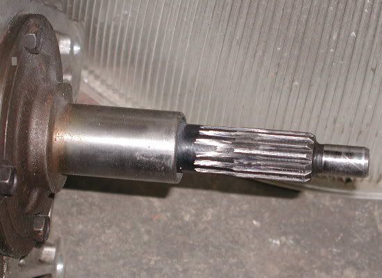

Got the engine running today and slapped on the drive shaft onto my new T5.... next problem in my chain of problems...cant put it in our out of gear with motor running. I think I have the clutch adjusted pretty close. I crawled under and checked out the action while the neighbor pressed the clutch pedal. I could clearly see the pressure plate pull back while the disc loosened - although it did stay close to the flywheel. I could take a screwdriver and move the disc a bit with the clutch in.
Hoping I could work it free, I then proceed to start the truck (in gear) going backwards then frontwards a few times. That allowed me to finally use the clutch to stop the truck (engine stll running). Still no gear changine. Then I proceeded to drive up and down the road in one gear. That process didnt change much...so hear I sit...any ideas
A little background on the install...I dont know if it was necessary but I did extended the splines on the tranny shaft..the disc did move freely on the shaft while off the truck...

I think the splines of the input shaft aren't cut far enough back to allow the disc to disengage from the flywheel. I've heard you need to grind some relief splines with a die grinder to resolve this problem,

Scott is totally correct in his analysis of your problem!!! I ran into the same problem with my T5 install....and cured the problem by slightly extending the splines.
I've documented the process with pictures and some instructions on page 5 of my Webshots "Shoebox". The key to getting the clutch to function properly, is to USE THE DISC on the massaged spline to make SURE it slides 3/16 to 1/4" past the end of the factory splines. If you don't slide on the disc and make sure it will slide past you may (or may not) solve your clutch drag problem. I hope this helps you solve your problem.

I did exend the splines and based on pre-measurements it sure looked like it would work...I guess its back on my back...good times

I did all of that as well as extend the splines..
[img]http://i8.photobucket.com/albums/a8/1tractorboy/PC200233.jpg?t=1166646706[/img]

from the picture it looks like the input shaft itself is not cut unless you can taper the end nicely.

I tried the washer trick and it works now!! Is it ok to leave the washers in or should I further extend those splines?
