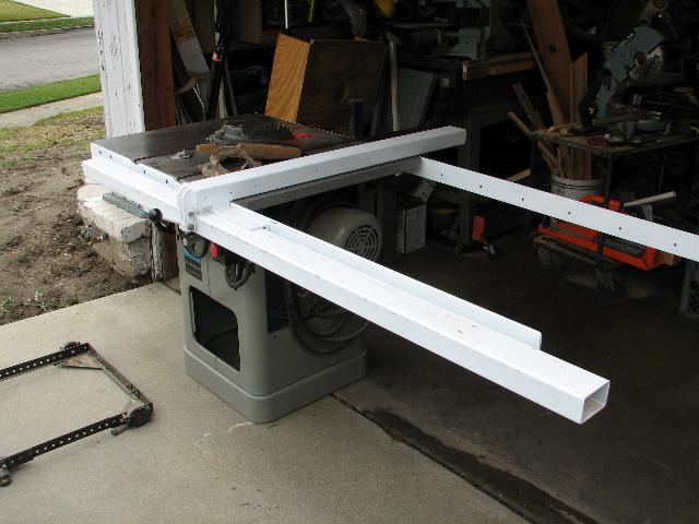

I waited and looked long and hard for my Unisaw. At the time, these were going for $700 -$1500. I found this one for $300. This picture is when I was reassembling it. Unisaw I had the cabinet powdercoated, cleaned the layer of rust off the table, had to get a couple of knobs and a piece for the single phase 220v motor. One of the better machines I ever purchased. A late 60's, early 70's Rockwell version. It came with the commercial fence and I've since filled in the table between the rails.
