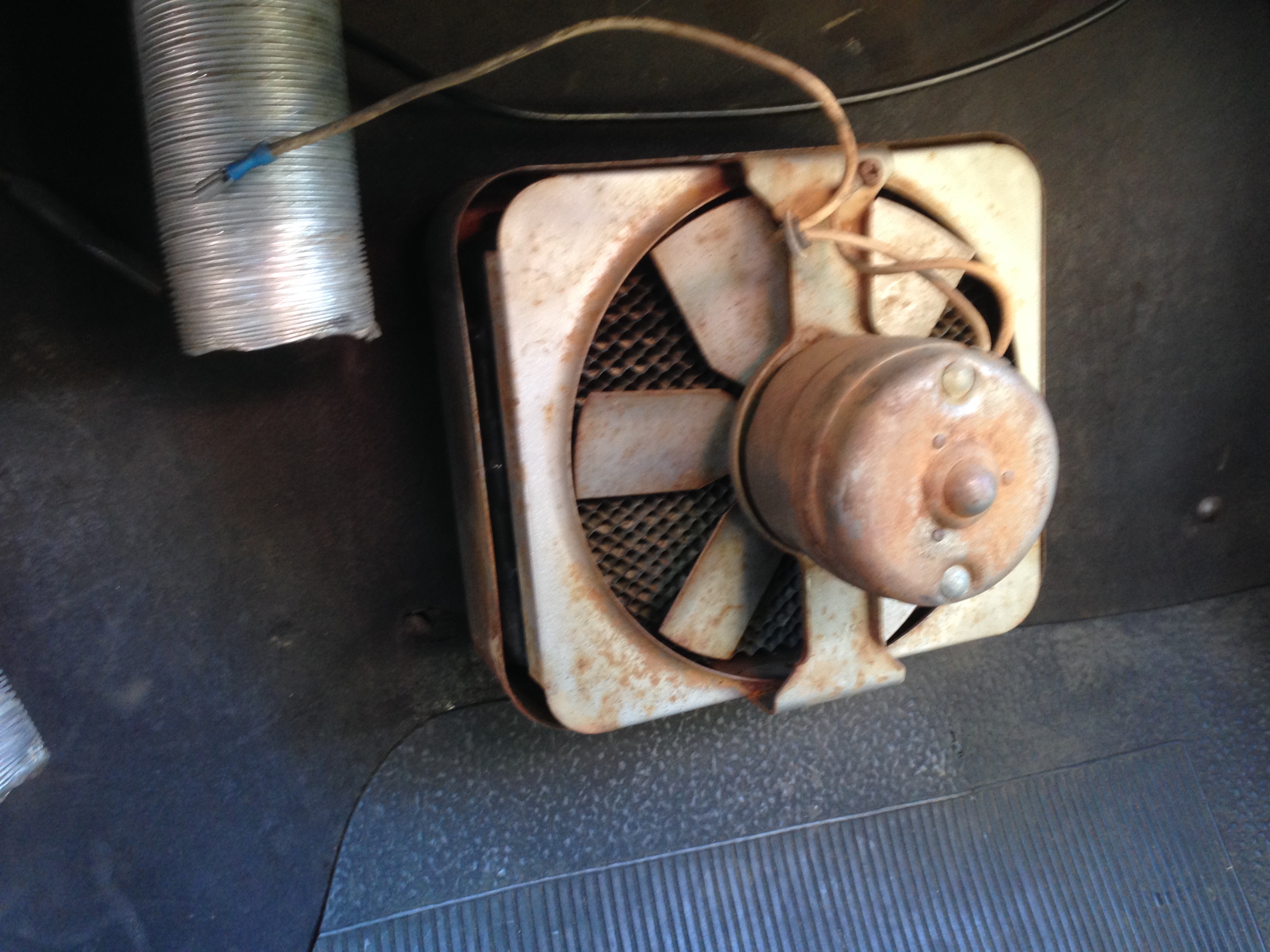

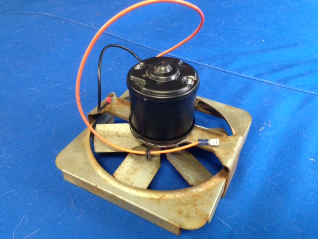

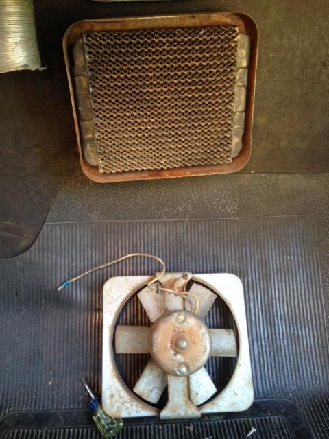

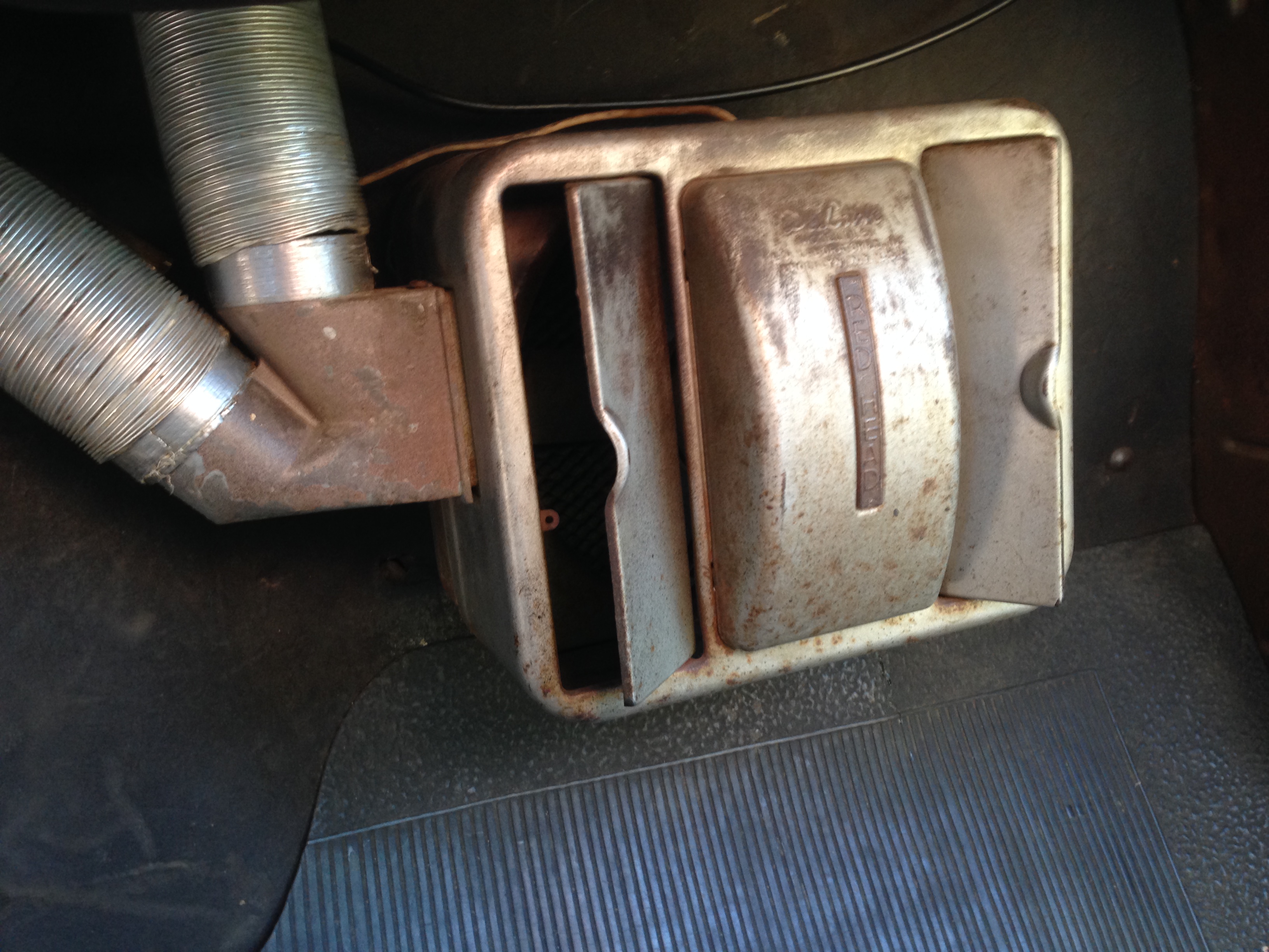

| | | | | Joined: Jan 2002 Posts: 2,845 'Bolter | | 'Bolter Joined: Jan 2002 Posts: 2,845 | With Greg_H's help, I landed a VDO PM354 motor from my local O'Reily's. Had to do some modifications to the heater motor support bracket due to the length of the new motor vs original. I had very little room so fitting the new motor was a bear. Nonetheless, got the new motor squished in and up and running. Will say it is far noisier at the slowest speed than my original 6v motor at it's fastest speed. Not sure how long I will last with it. Here's some pics: Pic 1 Pic 2 Pic 3 Pic 4

| | | | | Joined: Jan 2010 Posts: 4,263 Shop Shark | | Shop Shark Joined: Jan 2010 Posts: 4,263 | I used a similar motor on my 50 (Harrison), motor is not VDO brand but had a orange and black wire. Reversible depending what wire you grounded. The brand I used is unimotor 14522 it is very quite. Although mine is installed in the old 6 volt motor housing. I believe I purchased the motor at truck shop in orange. | | | | | Joined: Jan 2007 Posts: 70 Wrench Fetcher | | Wrench Fetcher Joined: Jan 2007 Posts: 70 | I'm currently running my 6 volt blower motor but have converted everything else to 12 volts. I did change my original heater switch to a 12 volt as the original would start to glow after about 20 seconds of running. Knowing that this is bad, I changed it out for 12v switch. I've been wanting to put the 12v fan motor in that I have on my bench (direct replacement supposedly) but just havn't done it yet. I'm about ready to though as I'm driving my truck nearly every day now and it is cold outside! My 6v motor is LOUD AS HELL! I think it is spinning at 5 time its recommended RPM cause there is some serious volume comming out of there as well. Question: Were you able to change out the motor without pulling the heater coil out? Second Q: I have the accessory power wire for my alternator connected to the back of my heater switch. Could this be the reason my heater spins so fast? My fan motor speed fluxuates with engine RPM (alternator output). Where else should I have that alternator wire connected for power when the key turns on? | | | | | Joined: Jan 2002 Posts: 2,845 'Bolter | | 'Bolter Joined: Jan 2002 Posts: 2,845 | It sounds like your heater fan is running on 12v. You should check this with a meter.
Yes, I was able to remove/replace the heater motor without touching the heater core....
But.....I hate the sound the new 12v heater motor is putting out. Way too loud of a wirrrring sound. Need to find another motor or go back to 6v with the resistor.
