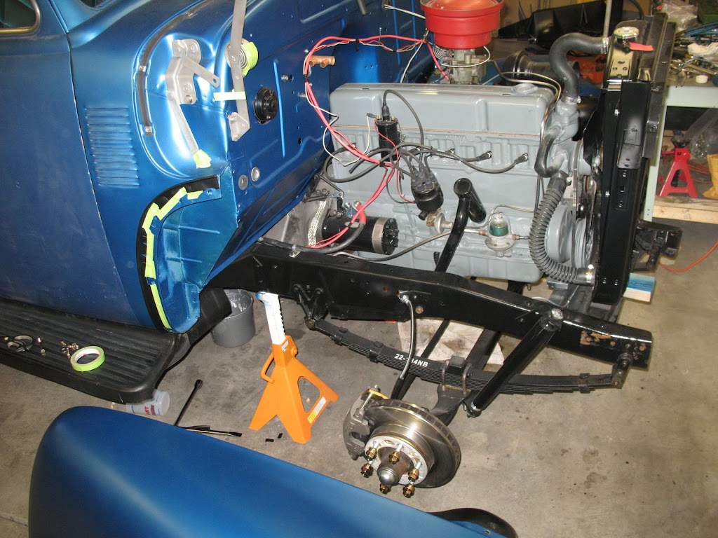

You could jumper it with a piece of hose at the water pump like in this pic
...pic...
Or you could jumper it at the firewall, where the hoses enter with a pipe fitting and hose clamps
