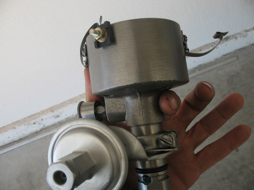

rgie #979930 10/20/2013 3:58 PM
Check napa also
I purchased one from there for my 54 235. It came with vac advanced and the grease cup
...pic...
If your new one comes with an o ring as in that pic, remove it.
