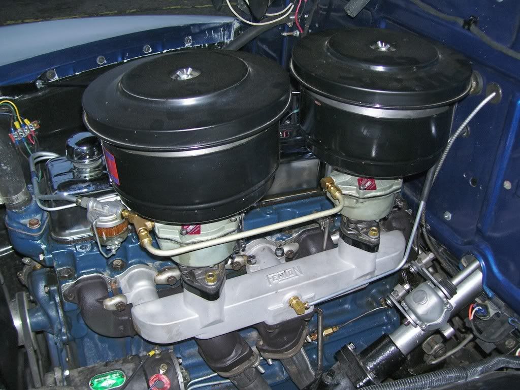

Joined: Mar 2005
Posts: 1,513
Joined: Mar 2005
Posts: 1,513
Originally Posted by Mr. Lang
You've got a "Donaldson" air cleaner. As far as I know, Donaldson made the oilbath aircleaners for the Canadian Trucks.
That is also my experience and additionally they have about 3/4" space between them when mounted on a Fenton intake. I'm guilty of just putting the U.S. repop stickers on mine.
