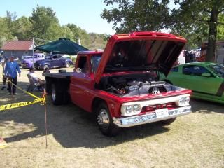

I have never seen a one ton at a show,
we folks in Tx must be missing something..
wait I take that back, I do know one
but he really wasn't at the show, just dropping of some tires..
here it is..
should be in the gallery, I will see if I can get the write up
here it is,,, a 59 so off topic...lol
real interesting guy, loves trains and such.. have not seen him in awhile

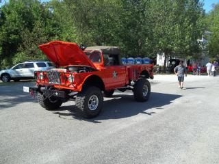

We don't get too many bigger trucks at the local shows, but some do show up. Like this 1 1/4 ton Jeep and this Kenworth.
