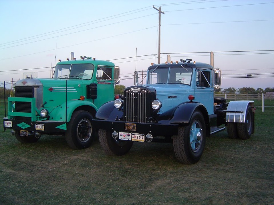

We don't get too many bigger trucks at the local shows, but some do show up. Like this 1 1/4 ton Jeep and this Kenworth.
