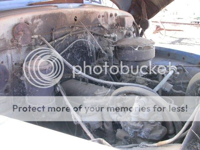

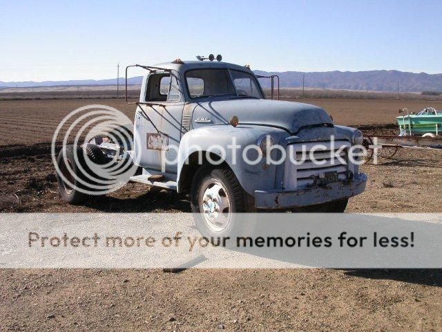

this is the truck in question,
http://i468.photobucket.com/albums/rr41/spanners1964/1145751fad27e71c63unit_zpsc927e750.jpg
http://i468.photobucket.com/albums/rr41/spanners1964/1145751fad27d6fd66unit_zps2c4cff8d.jpg
i,m awaiting delivery around 6 to 8 weeks and i,m trying to do as much research as possible but i have very little information to go on untill the boat comes in
we were told its a 1948 but we now believe it to be a 1951 , 450 or 470 .
