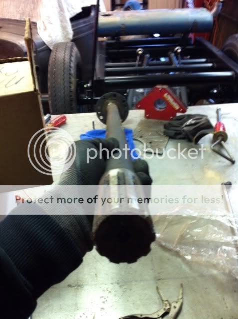

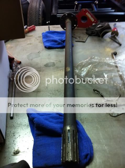

I do have a set of 10 spline axle shafts, they came out of my 36 but my 36 was a hodge lodge of parts... It was also a 2 speed rear end don't know if that means the axles are different then a single
http://i385.photobucket.com/albums/...8F-2987-000005AF6C617FEC_zps331d9255.jpg
http://i385.photobucket.com/albums/...5F-2987-000005AF70068DAA_zps4a113e85.jpg
Don't know if u still need them but let me know
