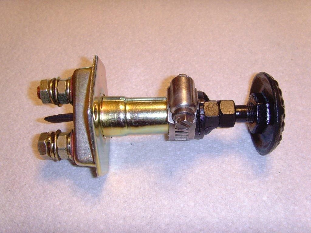

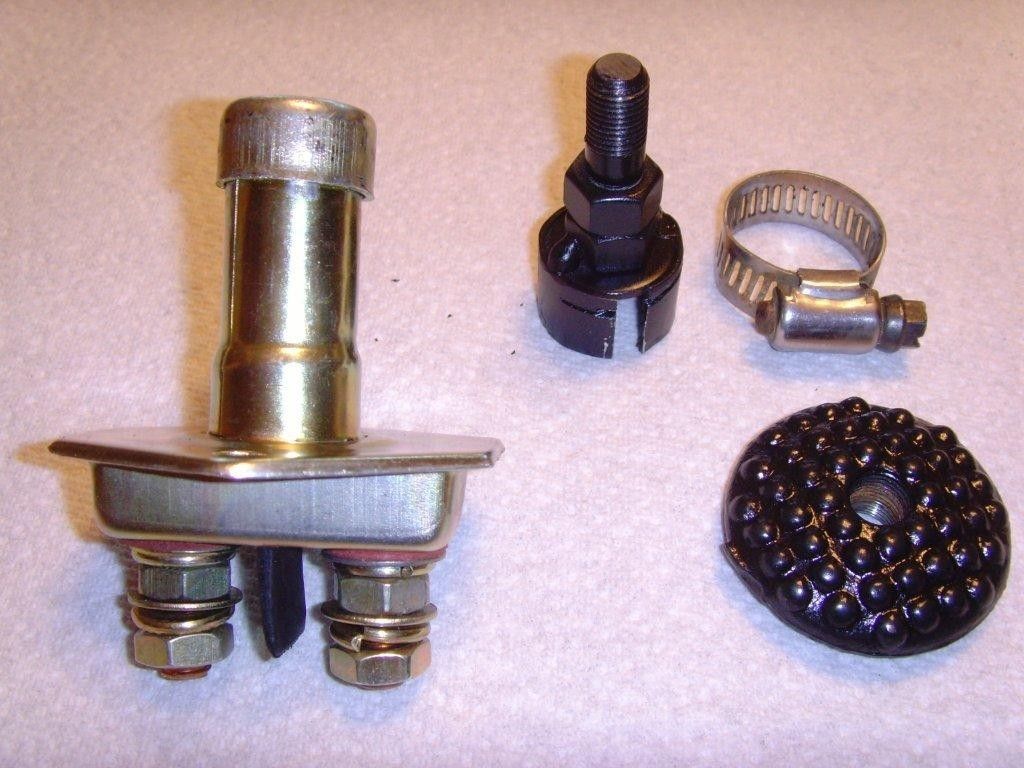

Bill | | | | | Joined: May 2005 Posts: 487 'Bolter | | 'Bolter Joined: May 2005 Posts: 487 | Here's what I came up with to have a foot starter with my 250/200-4R in my 57 3100. I used a foot starter switch for a tractor (Tractor Supply #0236643} . It will bolt to the floor and fit through the hole for the stock linkage. I built an adapter to allow me to attach the stock foot pedal to the switch. Here's a pic of the parts . And a pic of it assembled . After installing the rubber boot over it, it should look nearly stock. Comments welcomed. regards, Leon | | | | | Joined: Apr 2010 Posts: 245 'Bolter | | 'Bolter Joined: Apr 2010 Posts: 245 | Nice work Leon. Seems like a perfect reply. This belongs in the tech-tips section also. | | | | | Joined: Feb 2000 Posts: 120 'Bolter | | 'Bolter Joined: Feb 2000 Posts: 120 | Thanks Leon !
