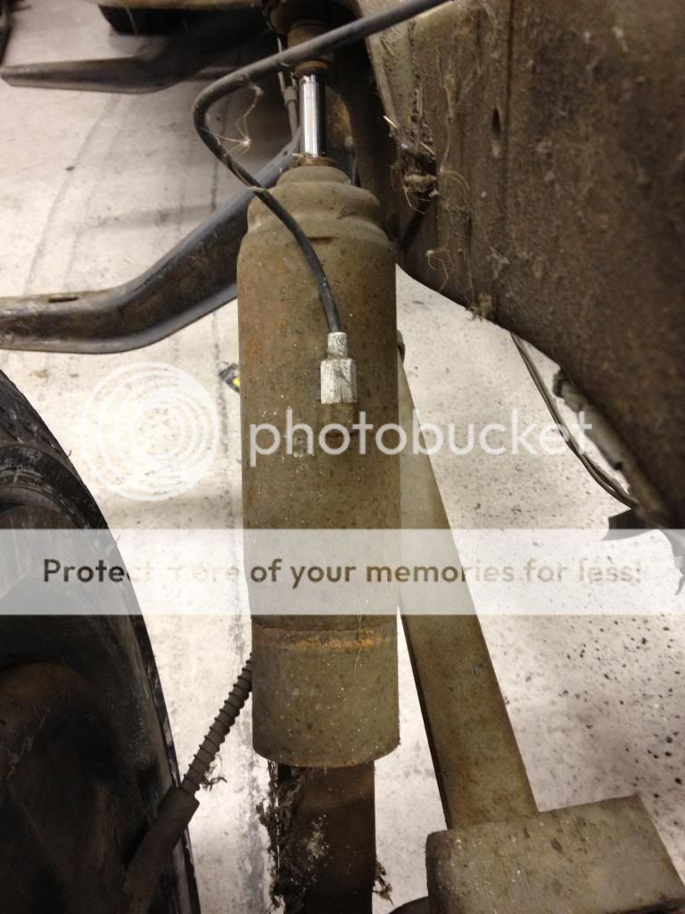

New on here so i dont know yet how to post a pic .has 6 wheel nuts . The truck has a 57 , 235 engine now .DEf has 3 springs with shocks that have an air line on them

You have a 1970's version air shock (Gabriel Hijackers nostalgia), from what I can see in the picture you have a 1/2-ton chassis.

Since I haven't dealt with very many of these trucks, the only thing I can say is it's 1950+ frame as the shocks are tubular shocks and not the lever action. From what I can tell the shocks look as though they are going into a stock location and aren't aftermarket made brackets.

Still a bit confused .I have the LMC catalogue . According to their drawings I have the front suspension detail of the 1st series 1/2 ton , but the rear suspension detail of the 3/4 ton. The main difference appears to be the rubber bump stop position
Any way , i have now located a 3/4 ton chassis just 10 miles form me here in england and so intend to swap the 3 leaf springs for the proper 7 leaf set and fit its shocks as well .Will be binning the air shocks!
