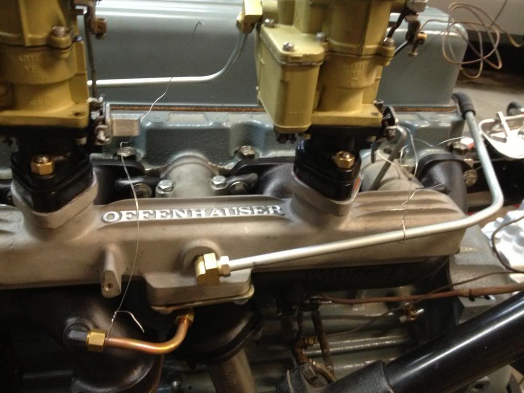

Bob Giles #910616 01/11/2013 1:03 AM
Joined: Dec 2011
Posts: 133
Joined: Dec 2011
Posts: 133
Here is where I picked up the vacuume and here is my PVC valve. NAPA # 2-9208. I was told that this may not be the correct valve due to it is not spring loaded and should be upright. I will have to figure out if I need a different valve.
