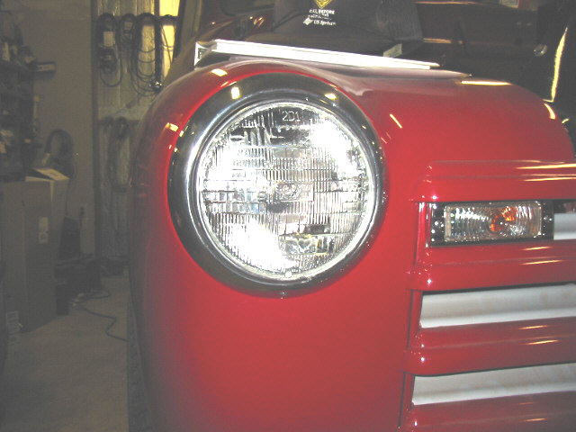

You don't like the light they put out, or don't like the appearance? Visually, they are identical to the original 6 volt sealed lamp. You have to be about 2 feet away to see any difference in the logo cast into the glass. Here's a photo of my truck with H6024 bulb.
[img]http://www.brakecylinder.com/images/52chevy/headlight.jpg[/img]
The light is brighter than a standard 6024 on 12 volts or 6006 on 6 volts, but does not have a noticeably different color.
Joe
