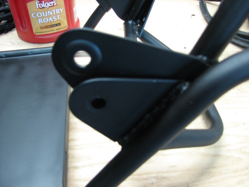

What type of hardware is used at this pivot point?? Shouldered bolt? Pivot tube? See picture.
http://www.bunchobikes.com/jumpseat.jpg

Mine had a barrel spacer between the brackets and a through bolt attached with an acorn nut.

Thanks George. From the size of the holes and shapes of the brackets, that's what I was thinking. Especially since the rest of the pivot points use barrel spacers.

I got those. It's where the seat bottom and the seat back connect that I'm concerned about.

a standard bolt and an acorn nut facing outward towards the passenger door if I recall

There is a bolt and a short metal sleeve and a acorn nut.
