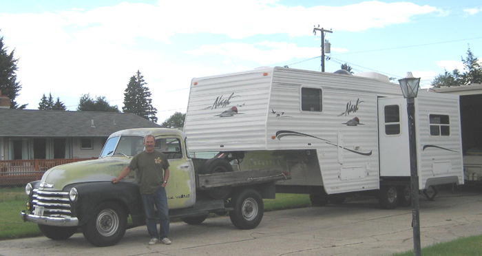

Pulling a trailer can be done.
My '48 with 5th-Wheel
Of course, backing the '48 under the 5th-wheel hitch, taking the pic and Photo Shopping the trailer jack stands away can also be done.
Sorry, I should have saved this for April 1.
