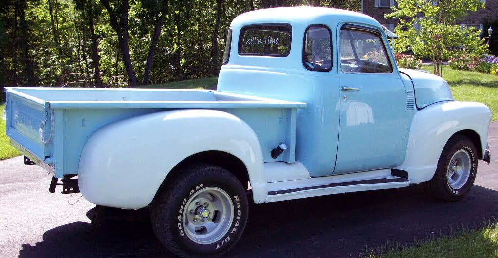

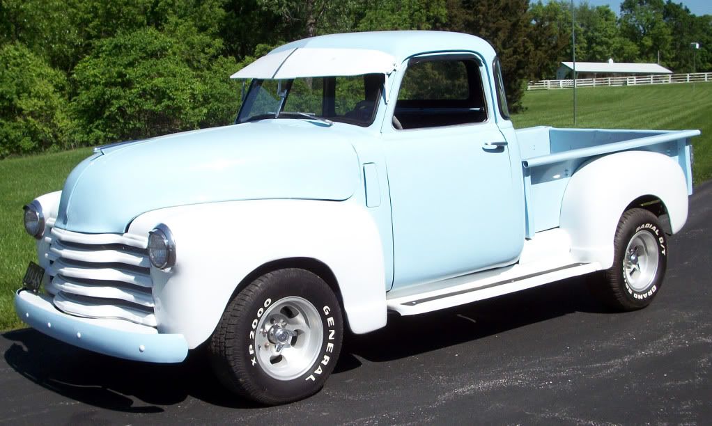

It was about a 200 mile round trip with a borrowed trailor and the first time I hauled anything that big. I was more nervous about whether I had it tied down good enough than anything else. Anyway, I had no problems, it was an uneventful trip other than having a number of people flash me a thumbs-up as they passed me on the highway.
Here are my initial observations after unloading it and putting it in the barn.

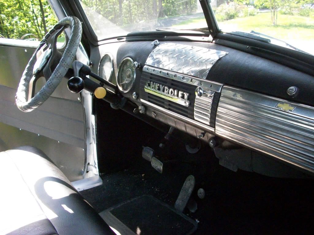

The brakes suck. I could see evidence of at least two wheel cylinders leaking and I had to pump the pedal to get any stopping at all. Also, the brake pedal is rubbing against something hard enough that I had to pull it back up with my foot.
When I put it into 1st gear and press in the clutch, I hear a grinding noise which I assume is the throwout bearing.
The old 6 cylinder starts right up and sounds real good. I don't think its the original 216, but I haven't had time to look it over to determine exactly what it is.

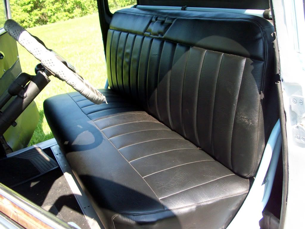

The stearing wheel is not original. It has been replaced with one that isn't modern, but is a smaller diameter.
Somebody carpeted the floor and moved the battery to the bed. I don't like that and will probably replace the carpet with a rubber mat so I can put the battery back where it belongs.

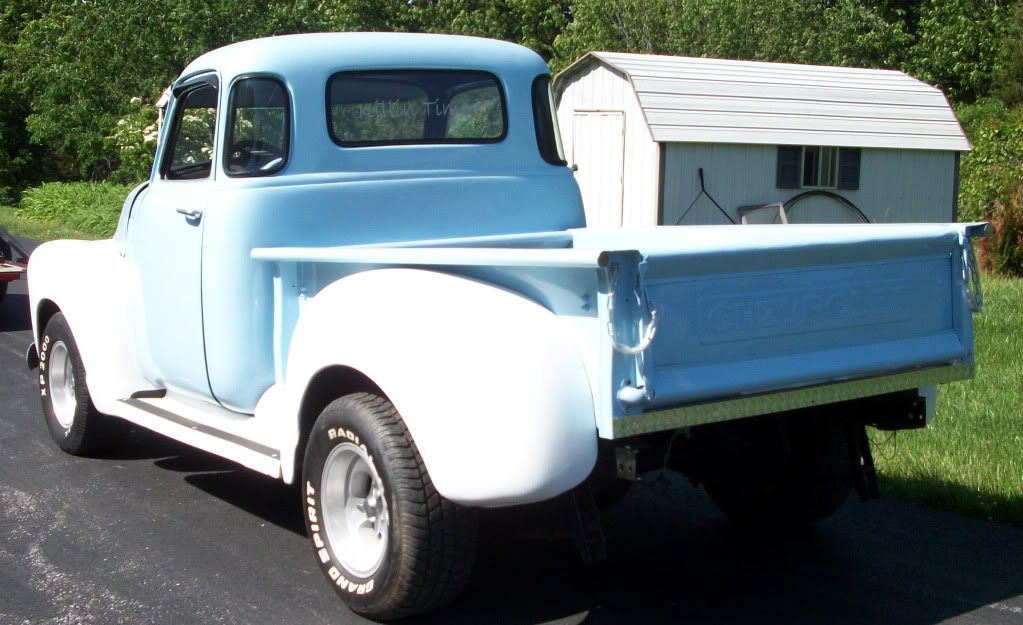

The frame is in really good shape. Almost no rust on it.
The aluminimum wheels and wide tires need to be replaced with original style steel wheels and skinnier radials. Its really hard to stear.
There are no lights on the rear. I would like to install reproduction tail lights and turn signals. The turn signals will also require lights up front.
That's it for now. Here are links to a few photos from right after I unloaded it.

Do you have any information on the Bed?

I know it's not orginal, but I like the chevy logo on the back of the seat.

Sharp. Like the gas tank upgrade.

The stuck brake pedal is symptomatic of weak cab mounts or wear. They usually sag on the drivers side because that is where people sit the most. It is a fairly simple fix lift the carpet to see where it rubs, then loosen the bolt holding the pedal to the shaft move it until it clears, then retighten. Great truck!

DADS50 - the wood bed is solid, but pretty ugly. It's older treated wood with no trim strips.

It did not look like a bed from a 48. But im not sure.

Nice truck!! I think the bed is off of a 1954/1955. You should be able to move the battery back & still have the carpet. I put a battery disconnect so that I wouldn't have to mess with the battery. Again nice job on the truck......

I wouldn't be surprised if the bed had been replaced at some point in time, but its news to me. How does the bed on my truck look different from a '48 bed?

The top edges of your bed are flat, and only the 54-55 trucks had that style of bed. On the 47-53 (and earlier) trucks this portion was angled. It looks like your bed is off a 54-55.

I'd like the story on the fuel tank and the filler outside of the bed if you can find out. I've been wanting to move mine out of the cab and under the bed and I like the way that one looks.

The first years of the Advance Design trucks had their gas tanks under the right side of the truck between the frame with the filler tub coming out the side. The panels and suburban used an almost identical tank that rested between the frame and under the back portion of the cab. The tank and straps are being reproduced by Jim Carter and the swap would be an easy one.
