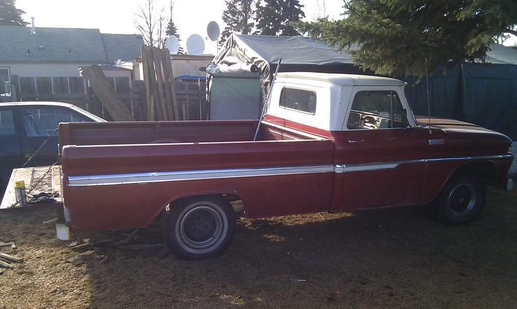

So I just got the second truck in today. I mean uhhh frame... http://i1106.photobucket.com/albums/h379/koneemen1992/photobucket-37643-1336878642861.jpg
I've got a lot of work to do and no nice asphalt surface to work off. Here goes.
Here's the second truck for giggles. Keep in mind that I really want a shortbed rather than a longbed. http://i1106.photobucket.com/albums/h379/koneemen1992/IMAG0056.jpg

First off, that is not a '63. It's a '60 - '62. No coil springs in the front on 60-62 trucks.
You can use the early frame under your '65 but it take some time and fabrication skills. Measure the width of your 65 vs. your parts truck.
Your '65 look like a good truck. Why not run it until you save up for the short bed stuff?
Are you in Anchorage?

I have a little hatchback that I commute back and forth to work in to save gas so I don't need to drive my 65 anyways. It has a few problems that need to be fixed before I'd feel safe driving it and I'm not big on the longbed mostly because I won't be using it as a work truck. I'd rather have a truck with a shorter wheelbase and they look better on the old trucks IMO.
The frame I got from a friend doesn't have springs in the front though. It has torsion bars which I'm trying to replace. Is it possible to just drop the torsion bars out along with the crossmember and replace the old front A arms with new ones and coil springs?
