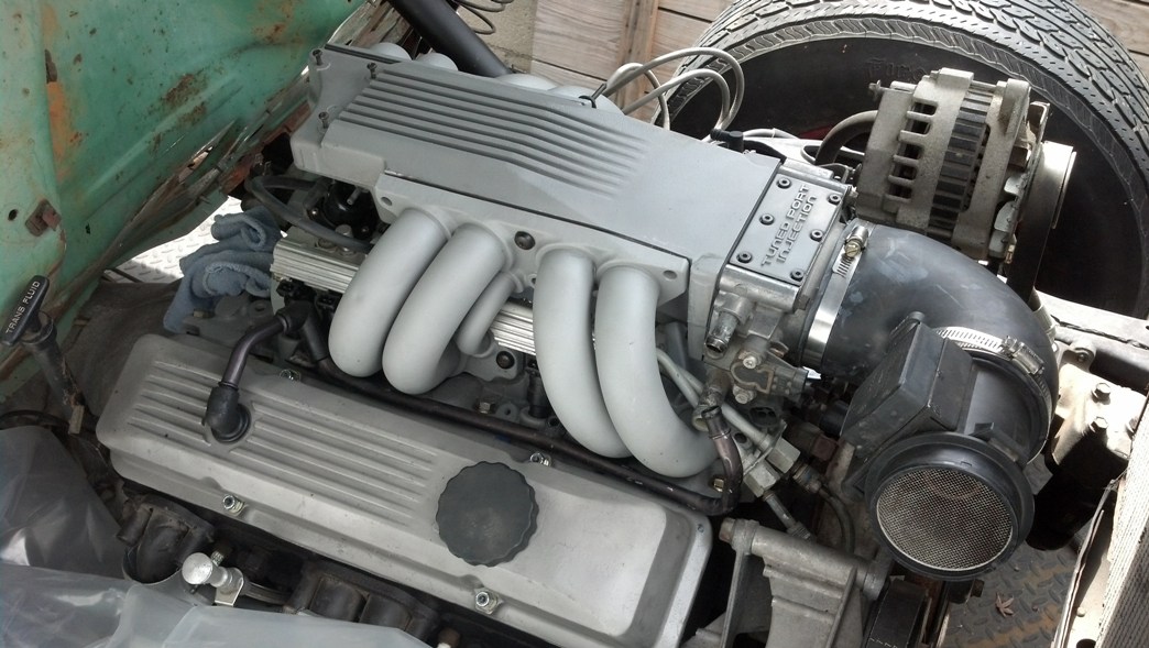

Still plugging away. Gotta get the intake figured out. Finalize the exhaust. Figure out what to do about the VSS and speedometer drive. Install the new radiator, install the new trans cooler lines. Throw in some engine wiring and I should be able to fire it pretty soon. Then I'll move on to wiring lights and the dash.
http://www.bunchobikes.com/1952suburban121.jpg
Mark, that engine sure looks like it's nestled in there real good. you gonna be cruising SOON.
