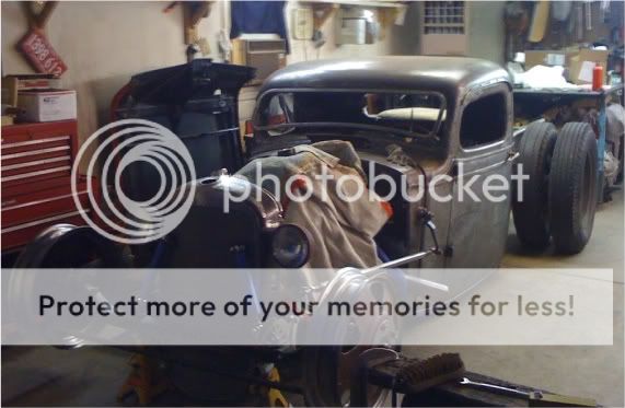

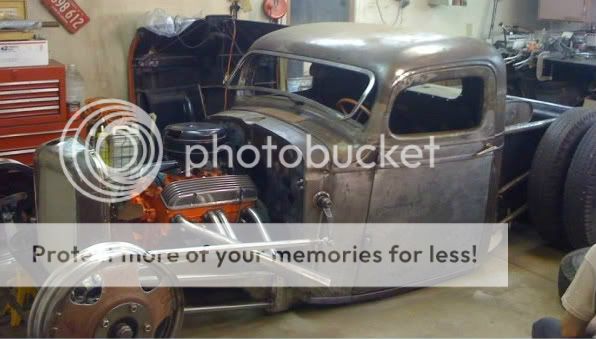

Hoping someone can help me out. I have been looking at ordering tires for my truck.
I have 4.5" rims on the front of my 36, and I know that you can fit 600-20 tires on them but I am hoping to run 550-20 tires. The 600-20's cross sectional width is 6.3" where the 550-20 is 5.9" The main reason I want to go with the 550 rather than the 600 is that they are 4 ply versus 6.My truck will never see any sort of load carrying, and I have been told that 4 ply will ride far nicer than a 6....
I emailed Coker with this question and his response was less than helpful, "it will probably work but I wont guarantee it will"
any thoughts???

Boy I'm glad you are blazing the trail for me on this truck. Have you considered all of the types of wheels that would fit on those Tahoe disks? If the disks fit over the original hubs, maybe there are some rat looking wheels that will take a better tire.
BTW, I love your truck and the innovations that you are putting into it.

IMHO, those wheels make the truck. Did you install new outers on some OG centers?
4ply should ride softer than the 6 plies, but I have no idea how much better.

Looking closely at your Photobucket pics, it's clear you have custom made one piece drop center rims up front. I didn't look that closely before my first reply, so your 4.5" statement is no doubt correct. I still think the 6.00" is the narrowest you'll want to go, but would suggest you check other sellers to ask the question. Places like Universal Tire, M.E. Miller, and Lucas Tire may be able to give an answer. Stu

Bob, the tahoe disks are mounted to the inside mounting pattern, where the original drums mounted. Couldn't mount rims there if I wanted. Plus I really wanted to maintain the original look

Yes, that is exactly what I did, I did a thread on how I did it a while back

well guys, I ended up going with the 550-20s for the front of my truck... fit just fine on the 4.5" rims. I will post up some photos shortly..
Thanks for everyone's input
