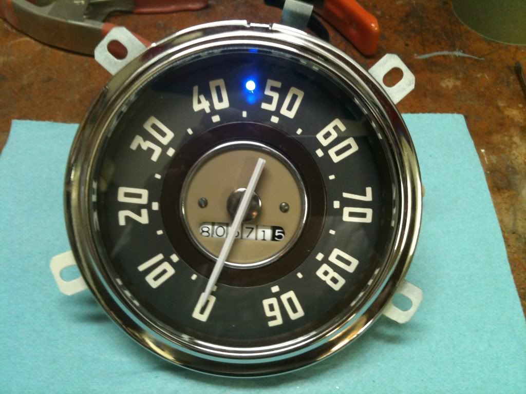

I used repop parts to rebuild the gauges. No issues with fit, finish or quality. Here is a photo of my restored speedo using all repop parts.
David, that looks good! Was that rebuild done with decals?
