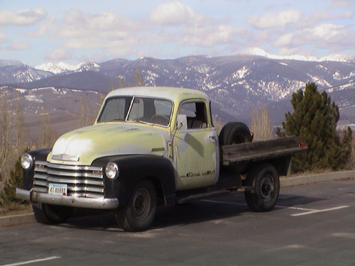

Pauledm55,
Here's a picture. As you can see, it's a life-long project. I'll have a full web page real soon.
My \'48.
