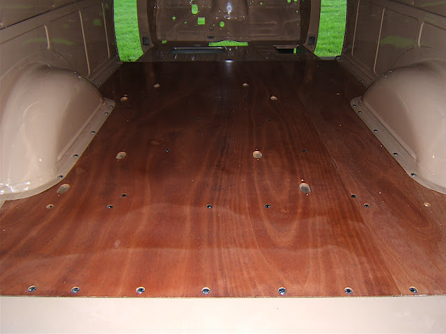

Originally Posted by bigtony55
I saw somewhere it showed someone step on redoing the wood floor itself does anyone have the link? and is the wood held in form the under side by those square nuts? top side are domed like carrage bolts?
WEEDS Lot's of pictures too!

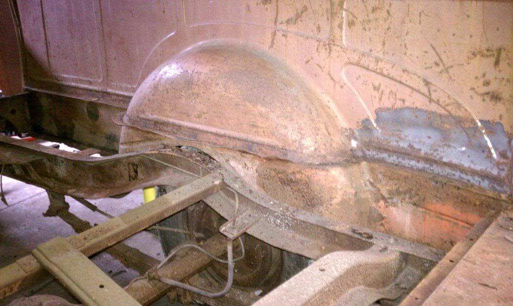

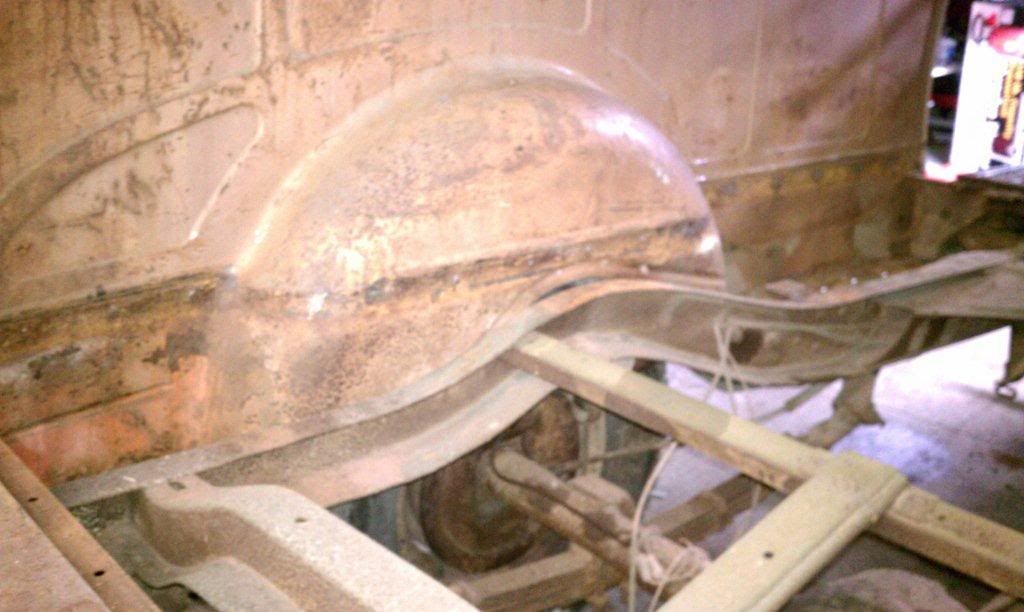

Is there a trick to getting the outer surround metaloff the one shown here in weeds pic i have all thecarriage bolts out but seems like the channel is rusted to the side wall??

You will need a grinder, it's welded in.

It should be visible from the top side against the body panels/wheel wells. No welding from below.
BTW: I have not done this, so I am guessing the grinder would be the best tool, you may need to use a chisel to minimize any damage.
Spot-weld cutter would be useful. There are over 20 spot welds that hold the angle strip to the side wall. Have you removed the paint from the strip? After doing that, you should be able to see the spot welds.
Do you intend to remove the plywood floor in one piece (and replace it as one new piece)?
I have not removed that strip or the floor, but I talked with a person who had done it. I cannot remember if, after the metal side strip was removed, the wood could be angled out the rear door, or if the wood had to be removed from below (with the body off the frame).

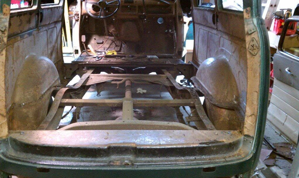

Ok i took one upper side off at the spot welds and we where able to get the floor out it was a work out for sure the problem was where the wood is wider at the front so it was a SUPER tight squeeze LOL

Bigtony55, you have accomplished what we have been saying was impossible for quite awhile! We have had great discussions on this subject and it was determined that you could NOT remove the wood from the top. Could you go into a little more detail on what it took you to remove it? Thanks

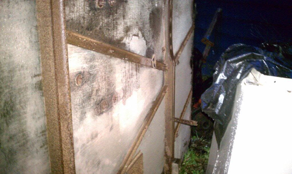

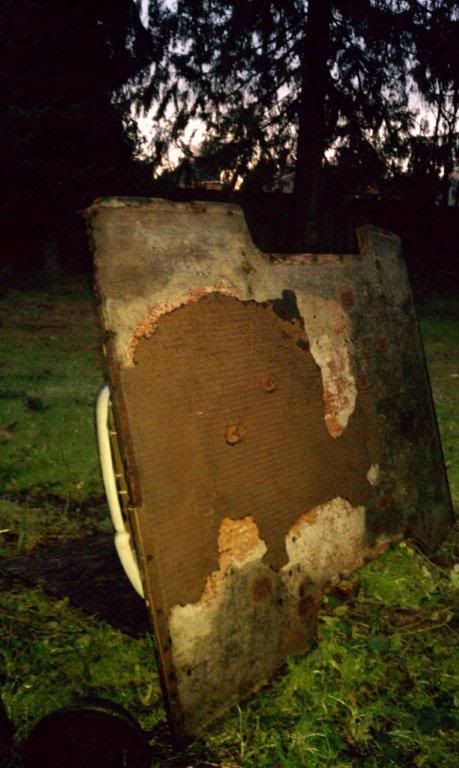

Ok guys we cheated a lil bit to get it out yes the body was one and yes we cam out the back but as you can see inthe one pics the upper part of the wood gave way when we did it which helped we came straight back as far as we could then started to rotar the back side of the wood up and out and various angle and with a lil UMPF LOL it popped out we only broke free one side of the channel too the main problem getting the woood up from the get go was the rolled edge in the wheel wells one we got past the getting it to the back wasnt so bad (soory i jumped around in my discription)
Channel still in pass side
http://i89.photobucket.com/albums/k237/bigtony55/IMAG1635.jpg
Channel out driver side
http://i89.photobucket.com/albums/k237/bigtony55/IMAG1634.jpg
floor out one peace
http://i89.photobucket.com/albums/k237/bigtony55/IMAG1624.jpg
underside will all braces still attached smile
http://i89.photobucket.com/albums/k237/bigtony55/IMAG1625.jpg
CHEATER CORNER THAT GAVE WAY
http://i89.photobucket.com/albums/k237/bigtony55/IMAG1626.jpg

bigtony55,
Thanks for the update/clarification.
If you will be making a new, single-piece replacement floor, be sure to take photos and let us know how this went.
Oh yeah, how many spot welds did you have to cut?

If i counted right it,the holes in side of panel anyways its 16-17 i wasnt 100% if the 17s was a hole from spot weld or not i had my buddy in there doing it for me
