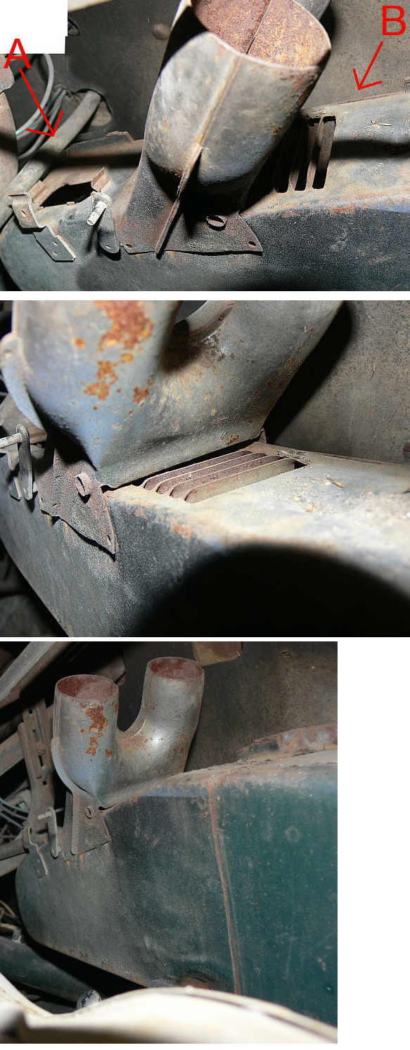

I need some help identifying the purpose of a cutout in my '52 3/4 ton heater/defroster (arrow "A" in photo).
Also, what's up with the exposed slats (arrow "B" in photo)? I'll have to look closer, maybe defrost outlet was moved???

It looks like the outlet has been moved. Can you post a photo of a frontal view of the heater?

I think "A" is where a ranco valve mounted, the brackets, one with the hole and one with the peg, would be where the control cable mounts, the bent flanges beside the hole would be where a component clicks in - "B" looks to me to be just additional warm air out when it's on full defrost position, I doubt they'd put louvers like that under the defrost outlet, and they do look factory
somebody appears to have re-shaped things where the e-brake handle musta been pinching their fingers against it, and they obviuosly wanted more heat on the drivers feet, choppin a hole in the end like that .... I'd be lookin for a new case!

Thanks Bill. Hey... I added another photo at the bottom of the page. Do you know what the lever that the arrow is pointing at is for?

another cable connection, the clamp above the arrow point holds the cable housing, the peg is where the cable end loop connects .... there's yet another cable connect setup at the left side of that pic - those are both prolly from the original installation in whatever it came from, the car had some fresh air controls, and the air input ran along the inner fender from an opening at the front next to the rad - prolly the installer tried to copy the same arrangement with that 'custom ductwork'

I moved the levers while the blower was on. The one on the left lets the air in from the blower, but the one on the right didn't have any effect. I'm thinking it might divert it past the heater core.
