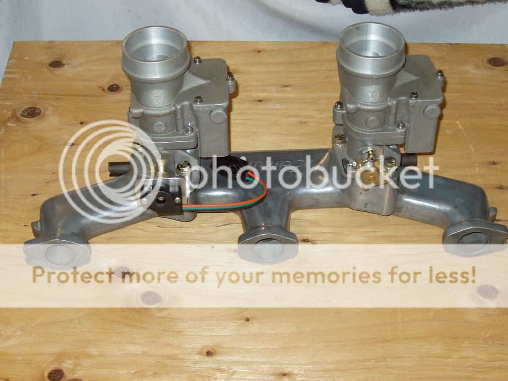

I decided to work on some of the peripheral items for my fuel injection system while I am waiting for the throttle bodies and intake manifold to arrive. First item is the distributor. I need a magnetic trigger signal for the ECM and a large cap to prevent arc over from the HEI system I am going to use. Since I am trying to keep this as nostalgic looking as possible a GM HEI is out. Too modern looking. I decided to marry a Chevy 235 distributor bottom to a Ford Duraspark top. I am going to use a GM ESC module mounted in a remote location. Timing advance will be controlled by the ECM. Attached are some pictures.
http://i532.photobucket.com/albums/ee330/diceman50/Hank%20fuel%20injection/P8080135.jpg
http://i532.photobucket.com/albums/ee330/diceman50/Hank%20fuel%20injection/P8080136.jpg
http://i532.photobucket.com/albums/ee330/diceman50/Hank%20fuel%20injection/P8080137.jpg

Will do Cletus. The plan at this time (subject to change) is to use a vintage Edmund's dual carb intake manifold with Retrotek throttle bodies. The electronics and sensors are all GM including the ECU which came out of a 92 Camaro 3.1 liter V6. Ignition will be via the Chevy/Ford distributor described earlier. At this time I am waiting on the throttle bodies.
http://i532.photobucket.com/albums/ee330/diceman50/Hank%20fuel%20injection/5f32_1.jpg

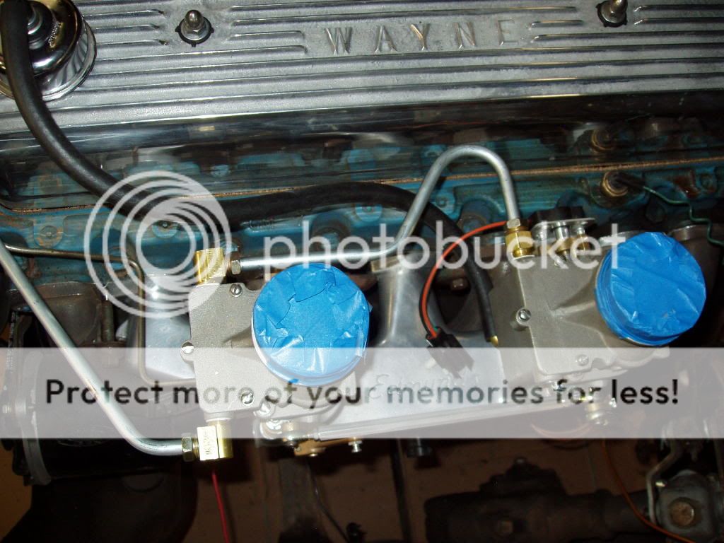

I am going to run a new 3/8" fuel line to the throttle bodies and use the original 5/16" line for the return. I haven't decided where I am going to put the fuel pump. In the tank is preferable, but in-line is easier. Wherever it is it will be well filtered with pre and post filters. This is my fourth fuel injection project on engines that were not originally injected so I am well aware of what is required. I have a very cool idea for the fuel pressure regulator. If it works I will show it to you later. If it doesn't work I will destroy the evidence as usual.

There has been some progress. I have resolved the following issues- IAC, TPS, MAP, IAT, ECT, knock sensor, HEI module, and throttle linkage. I am currently working on the fuel system. Progress will be slow for a while because I will have to fabricate the new dual exhaust system (mandrel bent stainless steel) and install the gear vendors overdrive unit. I have posted some pictures for your approval. Please let me know what you think.
http://i532.photobucket.com/albums/ee330/diceman50/Hank%20fuel%20injection/P4110002.jpg
http://i532.photobucket.com/albums/ee330/diceman50/Hank%20fuel%20injection/P4110008.jpg
http://i532.photobucket.com/albums/ee330/diceman50/Hank%20fuel%20injection/P4110017.jpg
http://i532.photobucket.com/albums/ee330/diceman50/Hank%20fuel%20injection/P4130005.jpg
http://i532.photobucket.com/albums/ee330/diceman50/Hank%20fuel%20injection/P4140009.jpg
http://i532.photobucket.com/albums/ee330/diceman50/Hank%20fuel%20injection/P4140011.jpg
http://i532.photobucket.com/albums/ee330/diceman50/Hank%20fuel%20injection/P4140012.jpg
http://i532.photobucket.com/albums/ee330/diceman50/Hank%20fuel%20injection/P4140013-1.jpg
http://i532.photobucket.com/albums/ee330/diceman50/Hank%20fuel%20injection/9.jpg
http://i532.photobucket.com/albums/ee330/diceman50/Hank%20fuel%20injection/7.jpg
http://i532.photobucket.com/albums/ee330/diceman50/Hank%20fuel%20injection/6.jpg
http://i532.photobucket.com/albums/ee330/diceman50/Hank%20fuel%20injection/10.jpg
http://i532.photobucket.com/albums/ee330/diceman50/Hank%20fuel%20injection/11.jpg

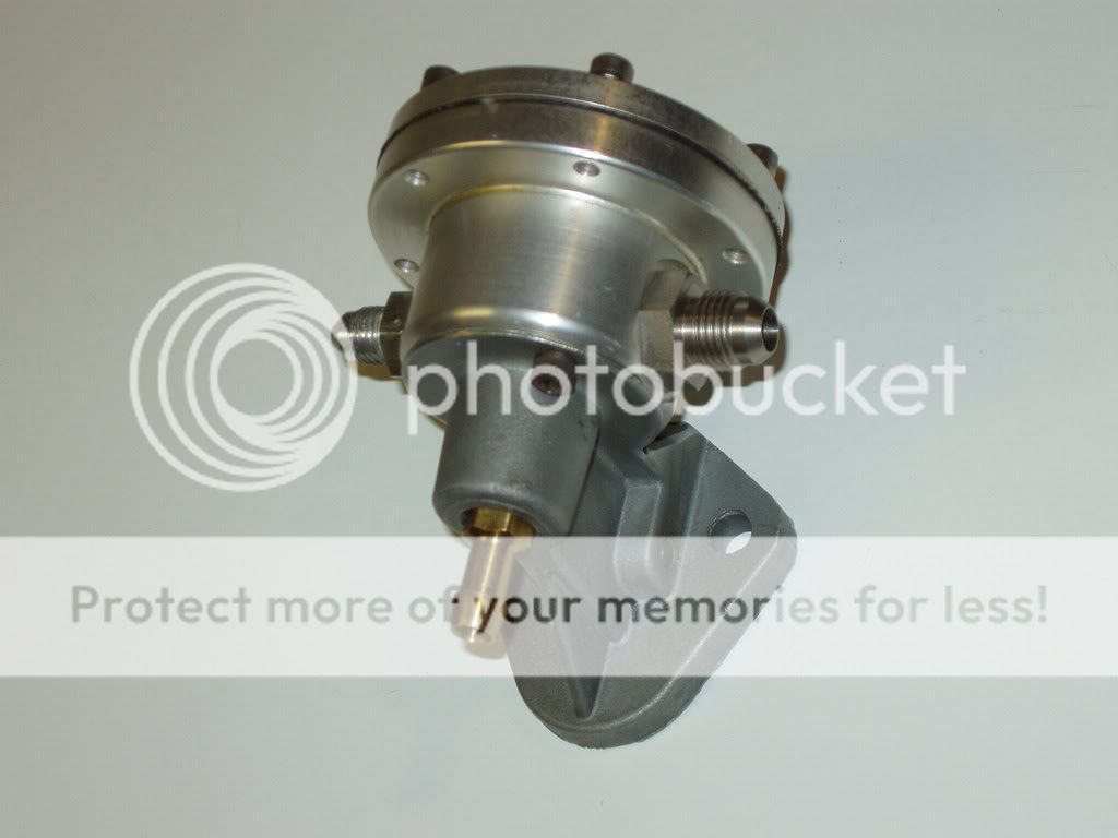

I cut he fuel pump off just above the base. Then i drilled and tapped a couple of 10-24 holes. The following picture shows it pretty well.
http://i532.photobucket.com/albums/ee330/diceman50/Hank%20fuel%20injection/P8140002.jpg
