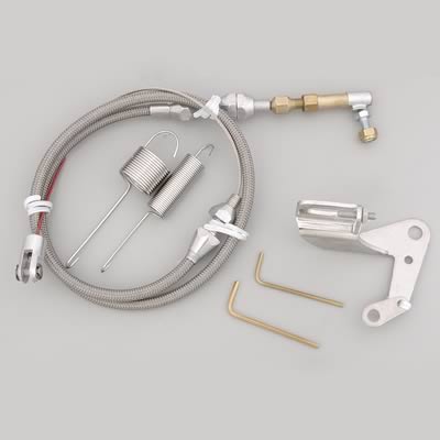

I've been in contact with Larry at Clifford-he suggested Summit for jets although he said they were readily available-
Czech and Drummin-do you have a source for the carb linkage-I believe we need to convert to a back and forth motion as opposed to the existing up and down?
Keith
Joined: Aug 2007
Posts: 610
Joined: Aug 2007
Posts: 610
I might just try to adapt a modern cable pedal, but thats just a thought, as im still waiting for my intake to be delivered and for me to order the carb, but its never to early to start planning things out.
Joined: Jan 2007
Posts: 615
Joined: Jan 2007
Posts: 615
Larry also states that there is a universal over the counter fix for the linkage-He used to sell it not sure if he still does

i like this setup,
http://www.lokar.com/product-descriptions/eliminator-fm-throttlepedals.htm
http://store.summitracing.com/partdetail.asp?part=LOK%2DFMG%2D6098&view=1&N=700+4294847984+4294891681+4294847971
a little on the expensive side but it will make for a very clean setup, then all i need to do is run the throttle cable up along the firewall and loop to the carb
That bridge hasn't been crossed yet so I'm open to suggestions on how to maintain my stock pedal and get the job done.

Todd, why not write back and ask for specifics.
The Holley DVD shows a couple different kinds of cable linkage they offer, but it's for newer cars. You would think with the limited number of carb options, and their manifold being used on specific engines that Clifford would have a market for linkage.
This is one thing that hasn't changed since the dawn of hot rods... carb linkage. It's always been a PITA.

I'll bet it just an adaptor to hook a stock Holley cable linkage to the Chevy bellcrank.

Seems to me it would have to convert up-and-down motion to back-and-forth motion and it seems reasonable that that could be accomplished by altering the belcrank..

Here's the deal on the throttle hook up.
I spoke to Dave at Clifford and they no longer sell 08-2428, but he gave me the number for Lokar (sp?) and I spoke to Vince over there and he told me that they make a throttle cable assembly that does the job. It's part number DP-1000HT and it can be bought from Summit Racing.
Here is the LINK
