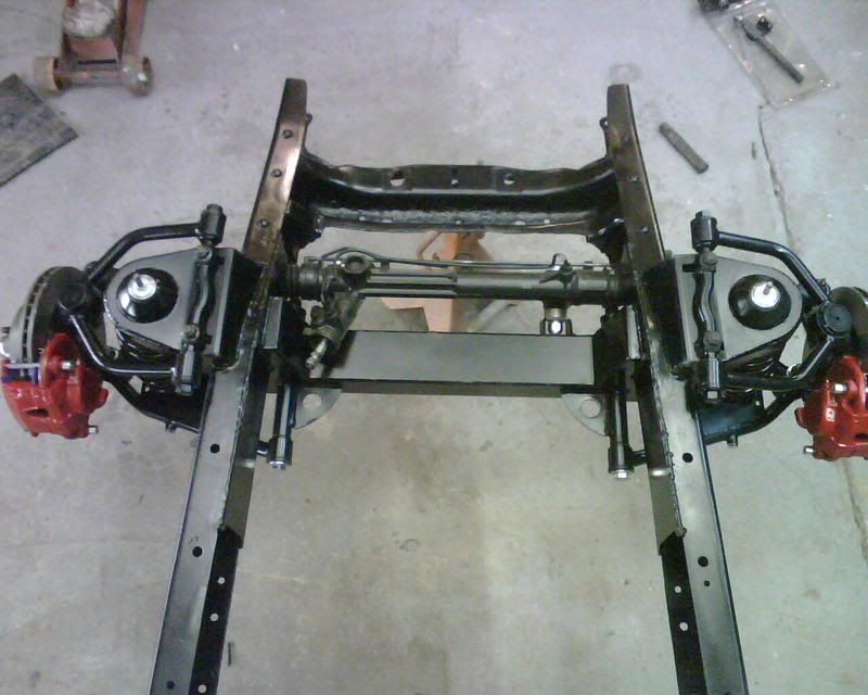

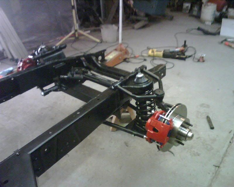

I am doing the same in my 50 model with a 5.3 out of a 2006 Tahoe. I just finished the mustang II install and have the weld in engine mounts with the tubular trans mount. I should be fitting the engine/trans in a few weeks. if anyone has pics that would be nice. I plan to take some as I go along, why wont the stock compressor work?
IFS installed
http://i11.photobucket.com/albums/a198/ahsum/ifs1.jpg
http://i11.photobucket.com/albums/a198/ahsum/ifs3.jpg
http://i11.photobucket.com/albums/a198/ahsum/ifs7.jpg

I don't think I will have exhaust clearance problems because I went with a Mustang II front suspension. I will just have to see where the compressor ends up with that new crossmember.
