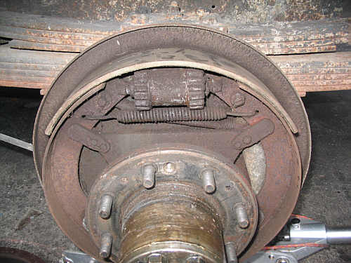

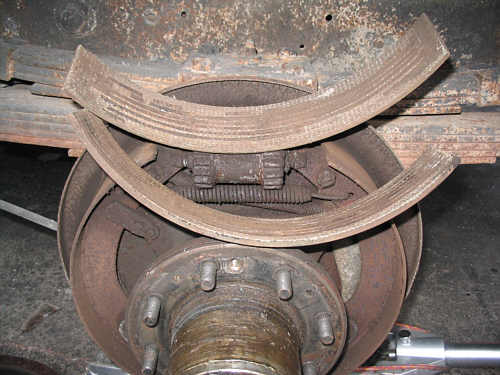

Here's reason #11 which I discovered today:
The brake material separated and jammed the drum.
I just brought home a 1952 dumper yesterday and noticed the parking brake wasn't working. When I jacked up the truck today, I couldn't turn the driver side wheel. I took off the drum and thought "why the heck is the brake shoe mounted on the top?" Until it fell on the ground! (See first photo).
What ticks me off is that the guy I bought it from claimed he spent $800 on new brakes. I'll be giving him a visit at his office on Monday. :mad:

Cheap Dumbas$ bonded brake lining...
Get some rivited linings when you replace the brake shoes....
