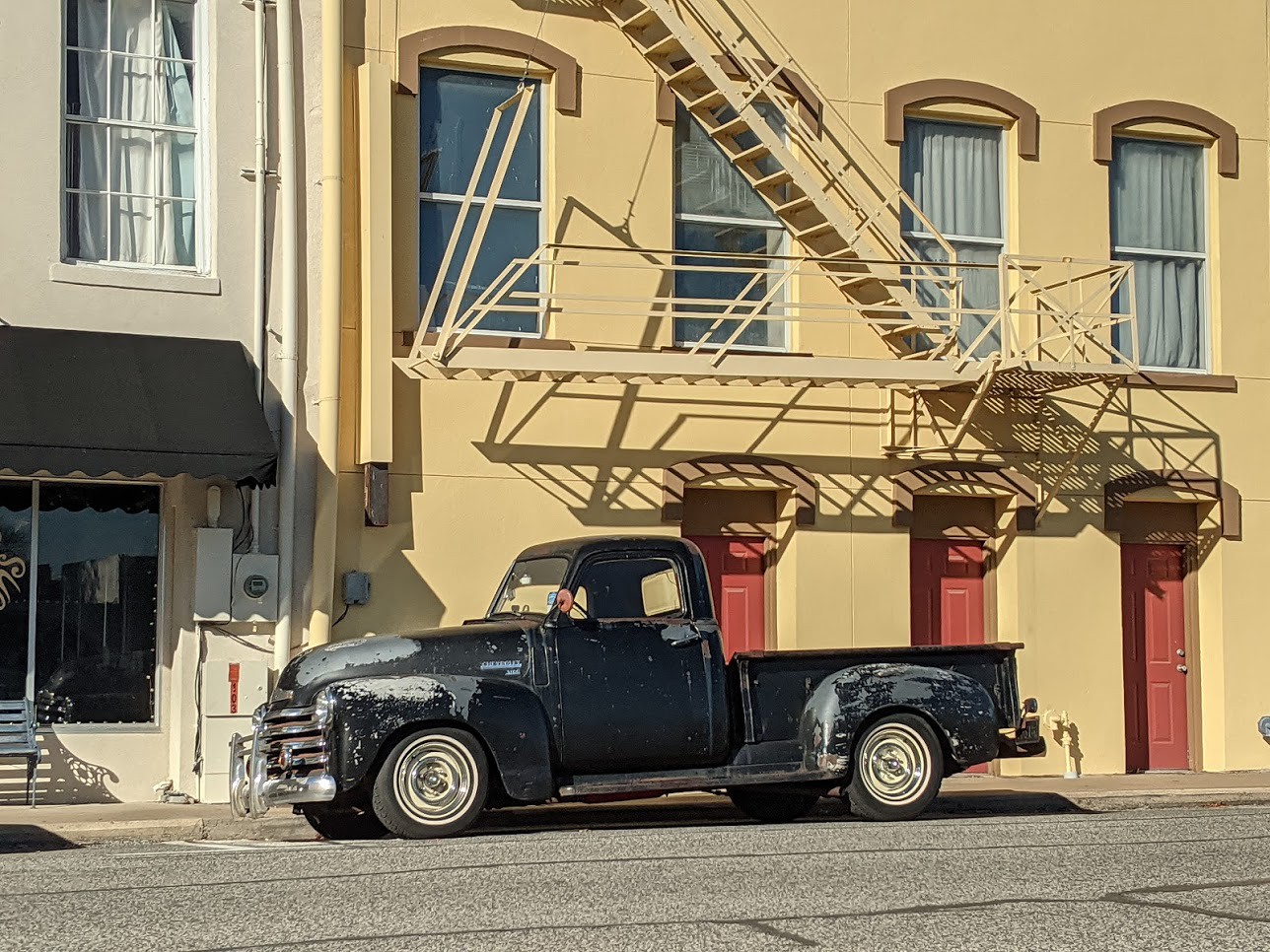

My truck has had a 3" axle done by Sid that was installed in 2016. With the proper caster and toe settings, and fresh tie rod and drag link with modern tie rod ends, it tracks beautifully and has ZERO bump steer. Highway speeds and two fingers on the wheel.
https://media.fotki.com/2v2H55bnWxDubp.jpg
