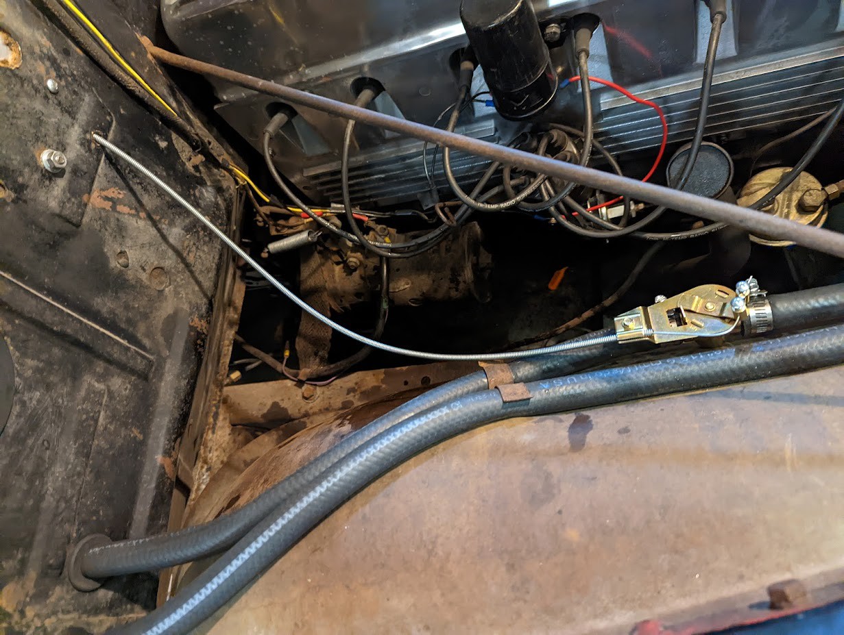

I have this valve on the hose going into the heater core that I use to open/close/regulate flow to the heater in lieu of the Ranco valve. It was around $20 at O'Reilly, and I use a $10 choke cable to work it from in the cab, but if all you want to do is isolate the heater, you don't need the cable. I don't know if there's risk of the system sucking air in through the leak or not.
