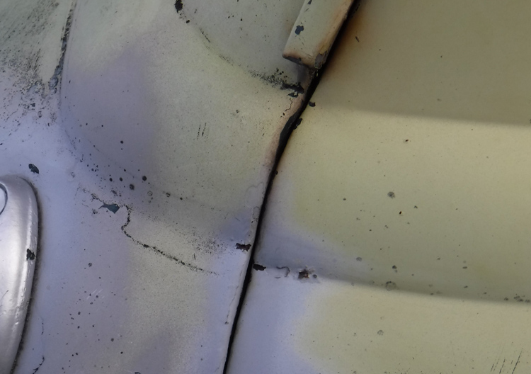

How far off is the beltline at the front of the door and the cab?

Ah yes. The beltline at the front of the door is about 1/4" (7/32" actually) lower than that on the cab. After lossening the 6 hinge bolts, the door still won't move up or down.
Beltline
