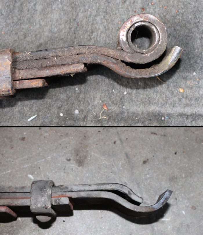

My '48 hung low to the left and the picture shows why. The left side spring was broken and had no wrap-around for attachment. It simply lifted and cushioned. I drove it like this for 20 years.
Springs, Good and Bad
