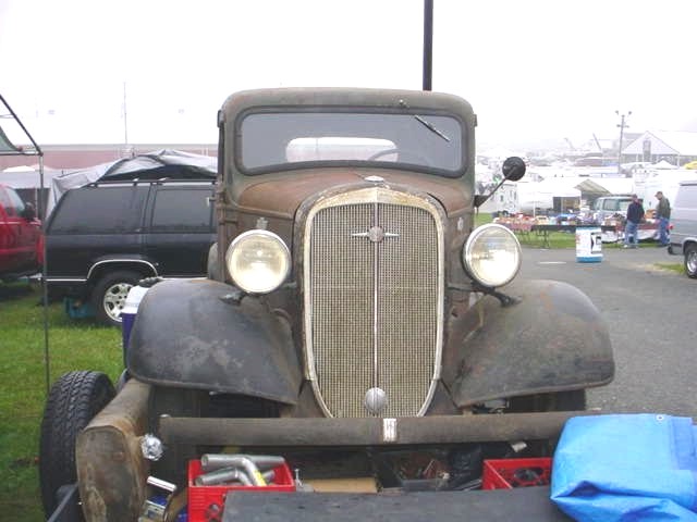

A few years ago while attending the Spring Swap Meet at Carlisle, PA .
I just walked into the swap meet a little after sun - up & lo and behold.....what do I see..... I see my dream truck on a trailer for sale for $5,800.00 .
It was a fresh barn find from north west PA .
After looking it over . I found that the engine turned over and was not stuck . The interior was complete nothing missing.
After 20 minutes of talking with the owner he said , I'll take $5,000.00 & deliver it to you over in New Jersey .
I could square shot boot myself in the rear for not buying it .
It would've driven me mad man bonkers hunting nos parts for a rebuild of that great north west PA. barn find .
PICS of the one that got away ,
https://i.postimg.cc/0NpJV70k/36-Chevy-Truck-A.jpg
https://i.postimg.cc/Y9MLZjd1/36-Chevy-Truck-B.jpg
George

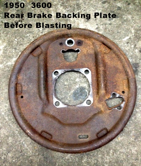

PICs before plating
https://i.postimg.cc/9fBYTCvQ/Parking-Brake-LEVER.jpg
https://i.postimg.cc/ydYXy2HX/brake-strut.jpg x 2

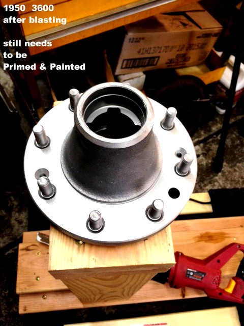

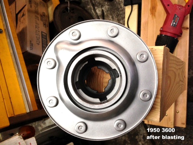

Here's a friends rear hubs that I blasted for him ( 1950 3600 )
before
https://i.postimg.cc/ZR9JGKPf/IMG-4304.jpg
https://i.postimg.cc/76fBxZNd/IMG-4303.jpg
after
https://i.postimg.cc/FFL9GzHz/IMG-4322.jpg
https://i.postimg.cc/909J7gKB/IMG-4319.jpg

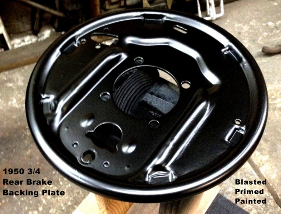

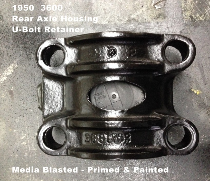

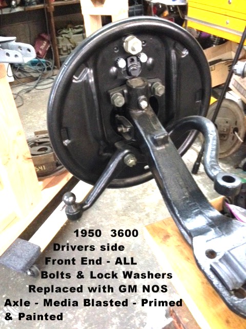

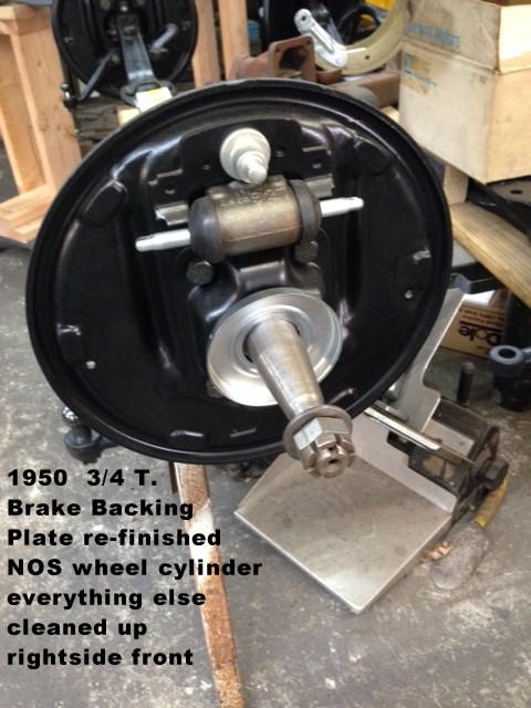

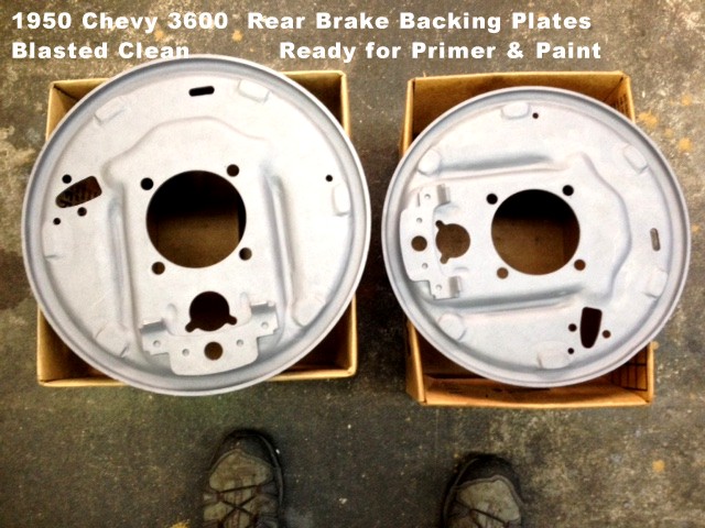

Here's some examples of parts from his truck that I blasted , primed & painted .
These are just some of the things I've been up to lately .
Not bad in my opinion for a truck that will be 70 years old next year .
What do you think ?
PICS
https://i.postimg.cc/mgXtx1QG/IMG-0059.jpg
https://i.postimg.cc/ZR3RyfXT/IMG-4310-2.jpg
https://i.postimg.cc/BtfJdtGT/IMG-4316.jpg
https://i.postimg.cc/Pr1DNwNk/IMG-4340.jpg
https://i.postimg.cc/1tNtTkqZ/IMG-4351.jpg
https://i.postimg.cc/65K3j16D/IMG-4324.jpg
https://i.postimg.cc/DZsv519v/IMG-4326.jpg
I've been using Black Diamond fine grit blasting media . Leaves a fine finish .
https://i.postimg.cc/zXnfLHZT/IMG-4362.jpg
Also been using fine glass beads .
Epoxy Primer & Top Coat Urethane
I've been waiting 5 to 7 days after primer to apply the urethane top coat .
https://i.postimg.cc/SKKQtZXG/Epoxy-Primer-Chassia-Black.jpg
I let the top coat sit for a week before handling for assembly .
