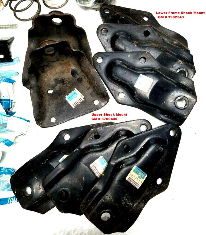

Why go thru all of the trouble to repair or fabricate new brackets
when you can buy GM NOS Lower Frame Shock Brackets - .GM # 3902543
These lower frame shock mounts are now a very rare part to find GM NOS .
GM # 3902543 was discontinued by GM in 1990.
The original GM part # was GM # 3882338 and was superseded in 1967 .
There is an auction on ebay that ends very early the morning of March 6th. @ 7:47 AM west coast time .
I would not miss this auction .
As a bonus in this odd lot auction it also has ( 2 ) upper shock brackets - GM # 3700440 .
These upper brackets would sell fast .
Sell the rest right back on ebay or right here on stovebolt.

Go to ebay & in the search box TYPE........3700440.........or..........3902543

I will check out that auction for sure. Thanks for the part numbers too! All I could find initially is those top frame mounts. Not sure if I could make those work or not.

Broken shock brackets are common on AD trucks and they make replacement ones, I thought they did for task force too. Mine had a coil over shock and that was the reason it broke, I'm sure. Stay away from these types of shocks, they have no reason to be there.

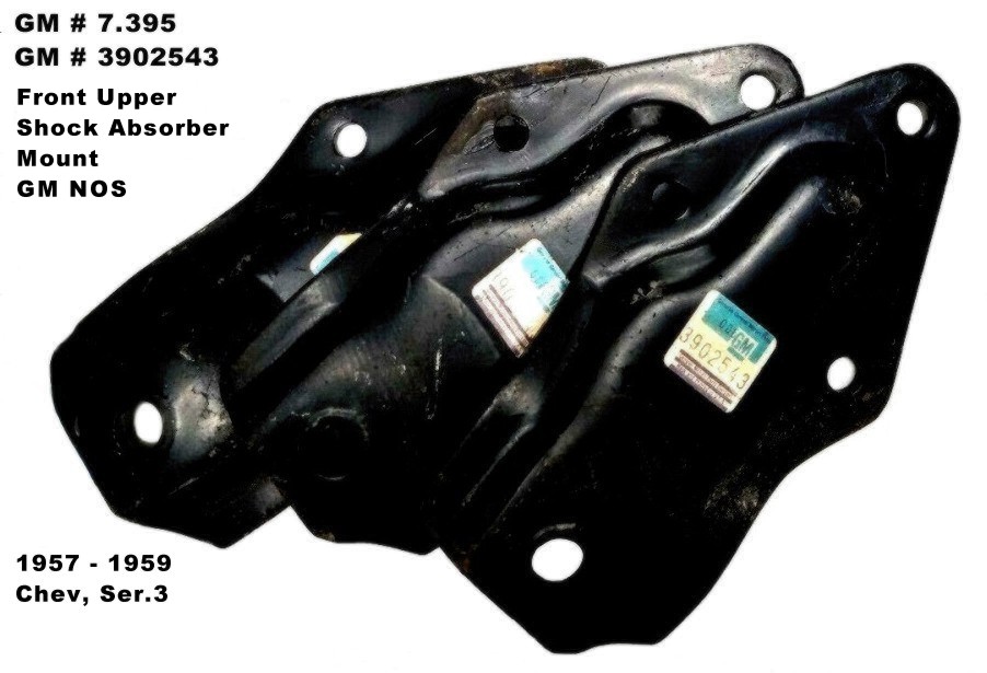

PIC
https://i.postimg.cc/cJDfW7WN/GM-3902543-Upper-Front-Shock-Mount-GM-NOS.jpg
Some people only know how to ridicule & don't know how to thank someone for their
help in finding a part . I'll know next time who NOT to help find a part .

I wonder why this says Lower shock mount when on my 59 its the upper?

Just to muddy the waters a little (I'm good at that!)- - - - -"AD" is also used on occasion to describe stovebolt trucks from the late 1930's and early 40's- - - - - -the "Art Deco" trucks. That's why the A-D description with the hyphen might be worth using.
Art Deco was not a Chevrolet designation, but it is a nice name.
Advance-Design was a Chevrolet designation.

Well, I called ebay.
They said they were going to notify the seller and he has until the 25th (march 2019) to send me a refund.
I want the money back sure but I wanted the parts worse.
54 3100 posted a picture and a part number but I cannot find them anywhere yet.
Guess I'm back to welding them myself.

I'm wondering if I can get them manufactured what kind of market would there be?
1959 Apache swb stepside
Atlanta Ga.
Try a parts-wanted ad, here in the Swap Meet. You got nothing to lose.
Maybe someone who has swapped out their front suspension will have those part in a pile of "scrap"?
Be sure the post make, model, year truck.
