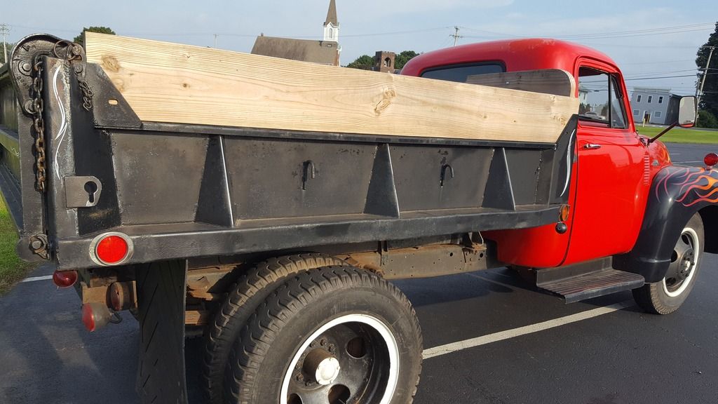

Thanks for the feedback - leaning towards buying her. Attached (hopefully) are some pics - no, I am not a flame guy.....

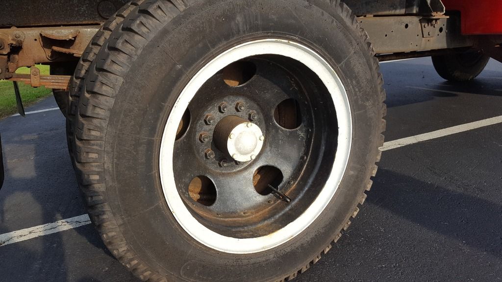

Appreciate any feedback on things you see in the pics, particularly about the wheels - I am no expert, but did not think these are Widowmakers... hope I am not wrong.[img]http://i1091.photobucket.com/albums/i397/stouchton/20181001_163038.jpg[/img]
http://i1091.photobucket.com/albums/i397/stouchton/20181001_164518.jpg
http://i1091.photobucket.com/albums/i397/stouchton/20181001_164532.jpg
http://i1091.photobucket.com/albums/i397/stouchton/20181001_164546.jpg
Does $5K seem reasonable for being drivable?

The wheels shown are the safe/serviceable kind of multi piece wheels.
Bumper is on upside down... perhaps that helps in your negotiating smile
Price is your call, is it worth it to you? My guess is it's in the right neighborhood, without having seen the truck in person to better judge condition.
Sometimes just because it looks nice and has paint on it doesn't mean it's worth more than an old original with faded and missing paint.. the "pretty" one might be full or rust and poor workmanship. Always cheaper and or better in the long run to buy the truck without rust, or with as little rust as you can afford up front. Replacing/fixing rust properly gets expensive, or corners are cut and it reappears.

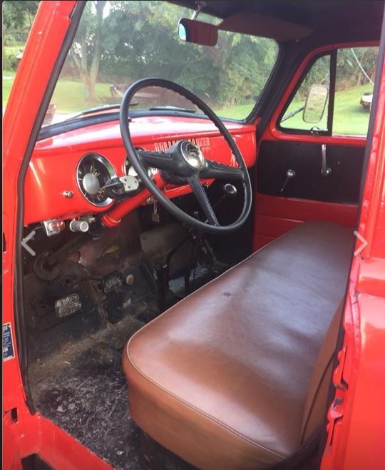

Here are some more details:
Interior is redone, new headliner, reupholstered seat, new door panels, dash repainted
All brake lines replaced
Front wheel cylinders replaced with 1"in place of 7/8".... don't know what to make of this...
Master cylinder replaced
Clutch, pressure plate and throwout bearing replaced
New radiator
235 babbitted engine replaced with 235 with insert bearings
Electric Wipers
Front brake drums replaced
Brake power assist rebuilt
New speedometer
Was inspected and on the road last year.

The wheel cyl. replacement will make the brakes more powerful, at the expense of less volume, which might not matter.
