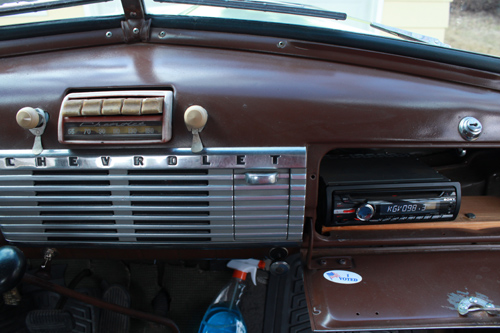

I've gone 12-volt mostly for better lights driving to work in the winter and having a modern AM/FM radio. The very quick starting with the original starter was a bonus.
Here's a picture of the $70 12-volt Sony radio in the glove box.
Note: The original radio has aftermarket knob bezels.
Old and New Radios Installed
