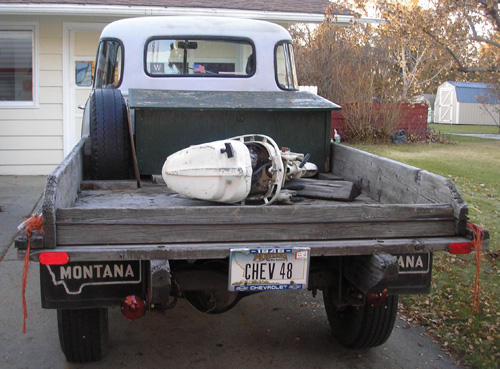

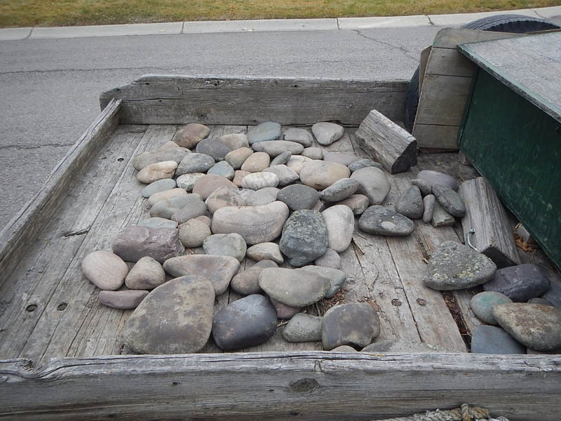

Most of my daily driver concerns rise to the top when it sits outside in winter.
The frost plug heater (under the intake manifold!) is my #1 winter improvement. At 20 below or colder, 4 hours of the heater on a timer lets it start right up like a warm summer day. I'll also use a magnetic heater overnight on the oil pan when it's really cold.
For winter weight, I've used firewood, rocks and a 1959 Mercury Mark 35A outboard.
Rocks from a favorite fishing place.
Old Merc.
Posts: 10,272
Renaissance Man
Renaissance Man
Posts: 10,272
The best use of a Mercury outboard I have ever seen. Ballast!
